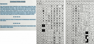

So here is information about the keyboard.
I get these sequences as described in these tables. For example when I press "23456789" I get "ABCDEFGH". It is the same sequence, it is just not what it should be.
Another example is "abcdef" which gives another vertical line "space ! " # $ %"
So the the X and Y in these tables are shifted.
But such problem is in the keyboard or the ROM tables? The ROM is able to execute and load DOS, so it should be the keyboard.

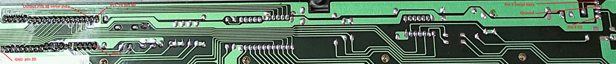

Dave, thank you for your help!
First I will need to measure pin 38 on the D8049HC with my LA, which should be pin 1 on the keyboard connector and pin 3 on the 8251 UART.
This way I will know from where the "wrong" scan code originates.
Above is a picture of the pins on the back of the card.
So I tested and it looks like the keyboard controller is sending wrong codes.
I pressed "f" and it gives 35 which is # and shows as # on the screen.
Still I am confused - was this intentional? Is the keyboard controller flashed specifically to work with a french computer or it is an error either in the controller or the lines that the controller is connected to?
According to this website https://geekhack.org/index.php?topic=86197.0 the codes sent from the keyboard should be ASCII codes. The control key (when used in conjunction with a standard key) causes a parity error...
If you are not getting ASCII character codes, either your keyboard is not working correctly, or your interpretation of the serial stream is in error.

I think we all agree that the keyboard is at fault. What we are trying to deduce is "why". What we need to do is to look around the keyboard matrix itself and deduce if there is something at fault there or not. If not, the problem must be the micro controller itself (by a process of elimination).
Do you have an oscilloscope? You have a logic analyser, right?
The first thing to do is to make sure you have a stable 5V supply at the micro controller. Pin 40 = +5V and pin 20 = 0V. Use a multimeter or oscilloscope.
The next thing is to check for the presence of a 6 MHz clock at pin 3 of the micro controller. Use an oscilloscope.
The next thing to check is that the outputs from the 4 to 16 decoder (74159) pins 1-11 and pin 13 are scanning. They should go low in an orderly fashion one at a time. No two pins should be low at the same time (although there may be an occasion where they are all high simultaneously). Use a logic analyser.
The next thing to do is to check the micro controller keyboard inputs (pins 27-34 of the micro controller). These should all be pulled up high with no keys pressed. Use a multimeter or oscilloscope.
When you press a single key, one (and only) input to the micro controller should go low - corresponding to the row and column of the key and the output form the 74159. Use a logic analyser, oscilloscope or logic probe.
The last thing to check is the serial output data from the micro controller (pin 38) WITH THE SPACE BAR PRESSED. Use an oscilloscope and post the recorded trace if you can.
