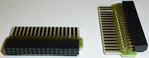

Hey there guys -- does anyone know a good and cheap source of these adapters?
I have been looking high and low to no avail. One place has them for $25 EACH -- which is shocking... Any ideas?
It's for adapting Gotek emulators to older machines using the old card-edge connector.
I only have one, and found it on the back of a tape drive.
Very handy. I expect it'd be quite easy to make the the PCBs and build.
Theoretically it should not be that hard to create the PCB yourself, buy the correct female pin header and assemble/solder it together yourself. Of course, you would have to order these in larger quantities, but it will probably be much cheaper than $25 per unit. I might be able to make the PCB for you if you want.
I have several, but you can't have them. They used to be standard kit on the 3.5" floppy adapters for mounting in 5.25" bays (which figures).
The simplest thing is to crimp a 34-pin IDC connector on an existing cable. Floppy cables could be had with 5 connectors--the pin header connector for the FDC and the edge and pin connectors for A and B drives.
I'll occasionally use one of the adapters when I need to use alternate drive selects on a drive--I'll simply cut the normal DS1 pin and wire the edge connector DS1 to whatever DS pin that I need on the drive. Comes in handy when you've got a drive jumpered/wired for DS0, but you need to test it on a PC.
Otherwise, I'll go with the IDC connector on the cable, for a very good reason--it's much harder to have a single connection come undone.

It's a lot easier to crimp the appropriate connector onto an already-existing cable.
And there were "universal" cables with 4 connectors on the drive end--2 for each drive.
