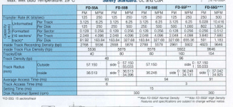

Hi @krebizfan - thanks for the link to the article, it looks very interesting - though what I'm looking for is the maximum read/write flux rates (positive to negative ) for the disk and drive itself - the controller might control the ultimate rate, but it cannot exceed the capacity of the disk to maintain the data.
Disks are usually measured in bits-per-inch I think, or something like that - and hence I assume the 720 disk is something 8,000,000 bits spread over 2 heads and 80 tracks, which equaltes to something like 60,000 reversals/rotation with 5-bit MFM symbols, or 300,000 flux reversals per second... It shouldn't have capacity above this with a non-hemispherical encoding system regardless of the clock technique due to the flux reversals will interfere with each other and data will be lost in time ( or so I believe, I could be wrong ) - and the data rate should be a lot lower than this, once the symbol system is decided on, with around 150 Kbps maximum for FM encoding.
But finding the maximum data rate for floppy disks is difficult to locate - I'm looking to see just how rapidly I can write flux reversals to a normal 720K disk ( and also, if available, the 360, 1.2 and 1.44 ) - so I can build my own symbol encoder/decoder ( or rather, for various reasons I'm specifically trying to avoid using a FDC, and maximum capacity isn't the primary issue ) - But knowing the maximum data rate of the FDD (of all of the common FDDs) would be helpful. I'm having trouble locating that information.

Commonly used bitrates are 250, 300 and 500KHz
The information is easily found in the data sheets for floppy disk controller ICs
Maximum bitrate of the media is determined by the formulation of the coating.
Bitrate of the drive is set by the filters and data separator of the drive's read channel.
You are going to have a very difficult time getting anything over 300KHz reliably on a
720K drive, especially on the inner tracks.

It's not the FDCs I'm looking to use - so I'm more interested in the maximum rate of the disk medium itself - rather than the rate at which the controller is set. -
Though that information you supplied is still helpful. It gives me a baseline to work from. I assume 250 KHz corresponds to typicaly DD disks and hence 250 reversals/sec. Or is that the bitrate for data recovered from the FDD?
here is the table for the common teac fd55 with the data rates that it was designed for
Hi @Al Kossow , - Bingo ! That's exactly what I'm looking for - Do you have that information for any 3.5" drives also? I never thought to look for the Floppy Disk Drive as the source of information.... I found it again quickly when I searched for the manual for the FD-55

Hi @Al Kossow - I found the other disks too - that was perfect. Seems I needed to look for the disk drives, not the disk specifications. I incorrectly assumed the disk specification was met by the drives, but the capabilities are mostly set by the drive itself.
A few quick searched quickly unearthed the rest of the material I wanted - Thanks again for the info - you got me onto the right track to find the rest also -

Those values in the table are just standard values for given data rates, modulation, and rotational speed. They don't talk about the real capacity of a drive, no holds barred. Anyone who's written a formatter is very familiar with them--they're needed to calculate inter-sector gaps.
Recall that a floppy disk system is very imperfect. The mechanism has to be tolerant of variations in vendor media (i.e. the goop smeared on the cookie) and the drive speed regulation itself. Tossing all that aside, suppose we talk about raw track capacity--one sector per track?
One thing that has to be considered is the fact that the read channel is very much analog in nature. Consider, for example, the iconic MC3470 read amplifier. Note that there's a low-pass filter on the thing to reduce the effects of high-frequency noise. You can adjust that to allow for a somewhat higher data rate, all other factors permitting. We did that with Tandon 100 tpi drives on our system and we could fit 12 sectors of 512 bytes on a DD 5.25" disk, using GCR--the downside is that the setup is a little more finicky when it comes to media.
And there are still surprises. I took that same system, attached a HD 3.5" drive and found that HD drives using new HD media at the somewhat higher data rate didn't work at all. On the other hand, finding a DD floppy that worked was extremely hit or miss (and I have a lot of new media to check that out). Oddly, HD media, even the pretty ratty stuff, worked if I taped over the media sense hole. One of these days, I'll haul out the 'scope and figure why that works. I suspect that the HD mode employs a bandpass filter with a specific "sweet spot".
