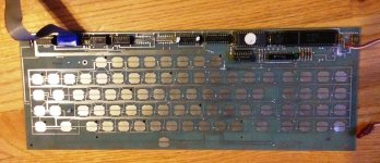

Does anyone have the keyboard ROM? The Bin file of the contents of the Eprom on the keytronic keyboard of the Franklin Ace 1000?

This is what the Franklin ACE KB I am working on looks like: 20210426_194135.jpg - franklin KB

I looked at 6 of the 7 keyboards in my possession and found two different circuit boards, but variations in how the common ones were populated.
Two have two 40 pin IC sockets, only one populated with the 8048 processor. The 8048 can run with either internal or external ROM. Both of the external ROMs have the ID "191" on them. I forgot to look at the chip type.
The other four fall into two population types:
Three do not have an external EPROM so they are running code in the 8048.
One, which is like yours, has an external EPROM. Unfortunately the EPROM is soldered in and my note on the board says it is non-functional. Who knows, maybe replacing a few chips will fix it. Since the EPROM is soldered I would have to extract it first before reading the code. I'm about to leave on vacation so this won't happen for a few weeks.
BTW can you read the label on the EPROM?
Another BTW. As far as I know, Franklin bought the keyboards ready to insert into our cases. Nobody from Engineering was ever involved with the code nor hardware design. I suspect the VP of Engineering (Dave McWherter) advised our contracts people about exactly what keycodes should be returned for each key but nothing beyond that.
Bob
Yes while testing the kb i desoldered and socketed everything on the kb. I will take a look at the label when i can.
edit: The sticker says "348"
I just tried replacing the P8035L controller on the pcb and now The only difference is the caps lock light stays on. Pressing keys does nothing.
The long and short is the owner of this machine put the keyboard ribbon cable in backwards and fried a couple passives(that's all we saw originally) I have replaced a couple bad TTL logic chip and I still cant get the board going. Everything seems fine, only thing left is the Eprom.
One of my ACE1000s has a keyboard with an EPROM. I've desoldered it and read it in; the image is attached.
Note: the original EPROM is an Intel 2758. It appears to be a single-voltage 2708, with a pinout matching the 2716 minus A10 (pin 19). I grounded pin 19 and read it as a 2716, so the resulting ROM dump is doubled. You should be able to burn it to a 2716 as-is, as pin 19 is grounded on the keyboard PCB.
Addendum: as the filename implies, the label on the EPROM says "231". I burned the image onto a 27C32 (quadrupling the image to account for the larger size), put it into the keyboard, and it works fine.
