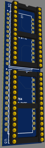

These are 8KB binaries so you need 24-pin 8KB EPROMs, which are not common. It appears that your existing EPROMs are MCM68766C EPROMs, which are 8KB EPROMs. So you could reuse those if you can erase them, and you have an EPROM programmer which is capable of programming them. Not all EPROM programmers support programming MCM68766C EPROMs.

The EPROMs are the hard to find. MC68766. 8kx8 in 24 pin package. Older ROM works but is not as user friendly and has fewer boot options. At this point we just want it to show any life sign on the console port.

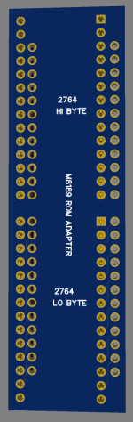

Thanks for the comments. I had made a simple adapter for 2764. I will test it when I receive the PCB from JLCPCB. Hopefully it works for M8189.
Thank you for all your help and comments. Finally, I am able to upgrade M8189 with newer version of ROM with a simple adapter and two M2764A's (200ns). The signal of RS232 can also be seen in oscilloscope. Thank you all again.

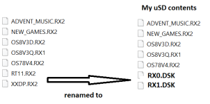

Did anyone successfully boot RX02 emulator ? My RX02 emulator is connected to M8029 (RX02 controller) and the switches of E102 on M8189 (processor board) was configured to boot RX02. I toggled "restart" switch (halt/run switch is set to "run" mode) but nothing happened.
First, what is the disk image on the uSD card you are using? Is it correctly assigned to drive 0?

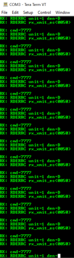

I assume you have the USB cable connected to a computer and the serial monitor being displayed in a terminal program. What does it display?
It would be nice to capture the terminal log and post it here.

1. The activity of LED's are same as what you decsribed.
2. The terminal shows below including three attempts to restart.
3. My uSD contents is
