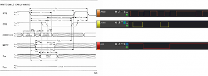

There could be a timing concern here but my limited understanding is by no means correct.
* "Operation within the tRCD (max) limit insures that tRAC (max) can be met. tRCD (max) is specified as a reference point only if tRCD is greater than the specified tRCD (max) limit, then access time is controlled exclusively by tCAC."
Likewise welcome! Don't let the initial moderation posting delay put you off, it wears off after a bit.
In the super slow PET the timing is much larger than the DRAM device allows so I don't think these constraints matter... or more precisely the nCAS (i.e. tCAC) does drive and it operates in a mode >> tRCD.

Greg, is it possible to get traces showing only read and only write cycling, for additional comparison? And I read you replaced most ICs but are these OG MOSTEKs? (I am skimming TI spec sheets also.)

From the trace back in post #123 I think we concluded that address $0000 was OK and things started to fail at address $0001.
From that trace I believe I could see a '1' being transiently written (erroneously) into D7 during the write cycle.
From post #133 trace #1 I think that was confirmed - but trace 2 (testing address $0000 only) was fine.
Two possibilities now present themselves:
1. Use the simplified code that we used for testing memory location $0000 out alone and modify that to use page 0 address $0001 and see what happens.
2. Start to look at the /RAS, /CAS and MUX timing. We have already looked at the 8-phase generator - but we may need to look a bit more closely at the subsequent timing logic.
I would propose we perform option 1 first - as the logic analyser is already set-up.
First use the sample code we had back in post #110.
Modify the following instructions and retest:
Where we had two (2) instances of
STA 0
LDA 0
Change to:
STA 1
LDA 1
Testing the code first with address $0000 should give us the same trace as in post #133 trace 2 (for comparison and check purposes).
Then modifying the code to use address $0001 should give us another trace for comparison.
All you need to do to change address $0000 to $0001 is to patch the second byte of each of the four (4) instructions from a $00 to a $01. The high byte of the address is assumed to be $00 because we are using page zero addressing mode.
Sound sensible?
If this indicates a timing problem - we can then move on to look at the DRAM control signals and logic.

The only other thing I wondered about is... if the row/col address muxing is the problem... then maybe we need to see MUXA in the analogue domain on a scope... the LA might be squaring things up in a way that might throw us off... but in the context of $0001 might be even better.
I'll take a few more traces of read and writes blown up for additional comparison.
Alright, exciting!
If there is both a timing and MUX concern, could that point to the root cause hiding in ( at least ) Clock Generator No. 1?

I think I may have this problem licked. I know Dave doesn't like swapping stuff randomly, but based on the fact that 1. We were pretty sure that the problem was timing-related and 2. I knew that I had faster LS parts in some locations that call for S or standard 74 parts on the schematics, I went ahead and replaced the 74LS74 I had in location H1 with a newly received 74S74. I put in the PETTESTER ROM and let it run without issue through 64 passes of the memory test over the course of about 2 hours without any errors.
Should I be satisfied that this is now working properly? Are there any other tests that I should do or should I just use it and see if anything crops up. I'm more than happy to do any other tests and measurements that you can suggest to verify operation or to wrap up any of the threads that we were discussing. I've retained the part and can easily swap it back in for comparison.
But, if there's nothing else to be done, I just want to make sure I thank you all for your help -- especially Nivag and Dave. I definitely owe you many beers or whatever other libation is to your liking. I hope maybe someday I'll get the chance to pay you back on that.
Also, I wanted to get a general feeling from the group as to whether I should upgrade the RAM from 16k to 32k. The pads are all present on the board and I have enough memory on hand to do it. The board is already very much not original from all the rework I've had to do to get to this point, but it's more-or-less equivalent to what it would have shipped with. Any opinions?
It worked, so I would take it!
Good to see that it passes my PETTESTER code (that is a pretty stressful test). However, I would still try our walking ‘1’ test just to make sure that doesn’t identify something awry.
Since you now have a socket in there for the 74x74 (H1) I would take s logic analyser trace (with the walking ‘1’ test that you have previously validated still works) to check what has happened to ‘fix’ the timing.
The worst case scenario here is that you are masking the problem by changing H1 rather than fixing the problem. If it was borderline erroring before, it may be borderline working now?

Wow! Well I wasn't expecting that! 74..74 devices are notorious in their failure like ...161s etc but I was NOT looking in that part of the circuit!
Now... We should have spotted that on a scope picture of nRAS0... might have to look back.
The fundamental difference between a 74LS74 and a 74S74 is output drive. A 74S74 can pull down 20mA whereas a 74LS74 can do less than half that!
For my own amusement I would want to see a scope trace of nRAS and MUX together with old and new... I suspect you might find the relative timing might have a slight difference.
But.. don't chase red herrings down rabbit holes... a win is a WIN!
Good job
The timing should be locked to a clock pulse (one of the 8 phases) and not left to the whim of a gate delay or pull-down capability.
At that frequency - any type of 'slow' gate should really work IMHO.
I suspect we have not fixed the fault - only masked it - unless H1 really was 'dead ish'.
You may find (for example) it is really H2 or H4 - and putting a faster gate in place of H1 has just shifted the errant pulse slightly to the left or right (thus masking the problem only for it to reappear again as the machine continues to age further).

I finally got a little quality time with the PET tonight. I took some traces with the walking bit test. Here is an example of it when it is writing a "1" to RD7 at address $00 and reading it back.
To my eye, this looks correct.
