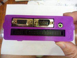

We also continue to work at the AZ BK
The enclosure specialist has developed an excellent enclosure
