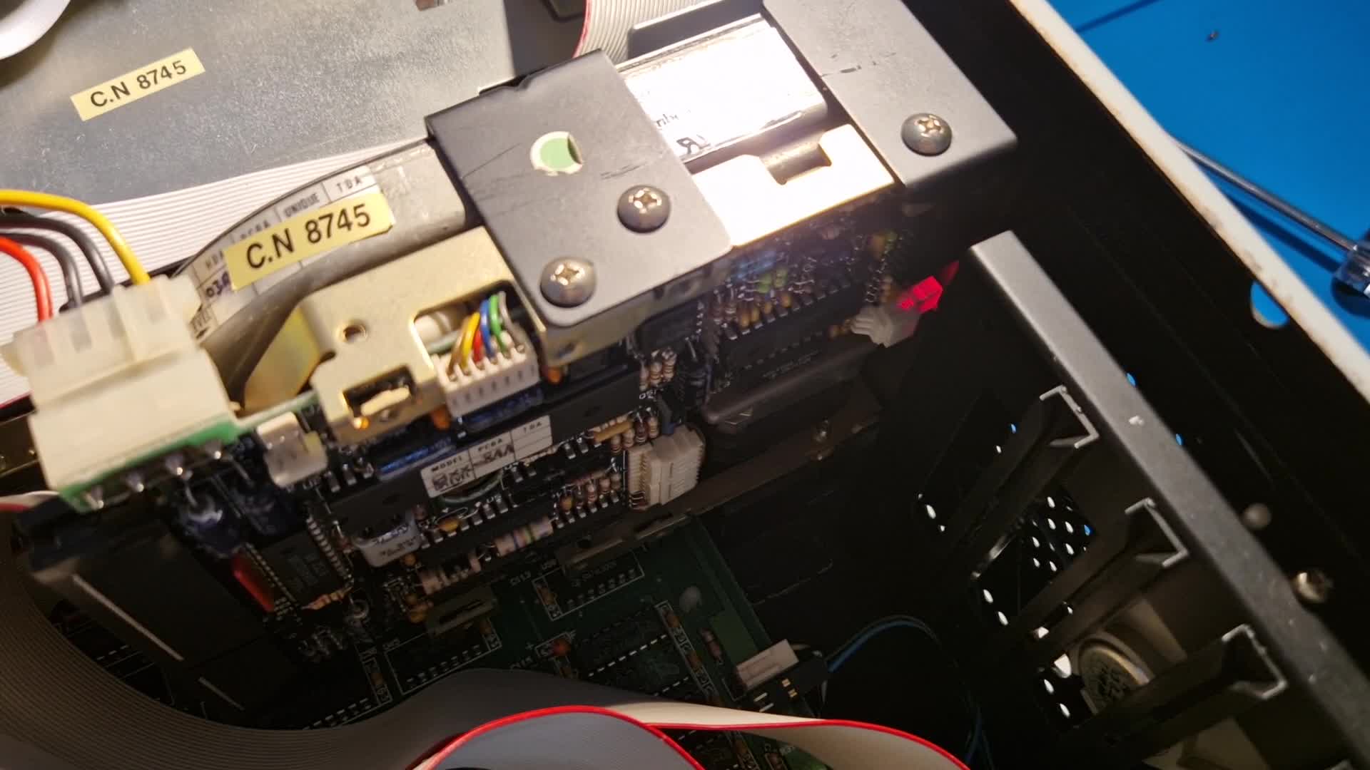

Hi all
I have an XT clone with a Transteque HC-101 A1 controller card and a MiniScribe 8438 hard disk. It was working fine a few weeks ago but now it spins up and a moment later down again, then flashes an error code:
According to this it's "Code 4 - Index pulse not detected during spinup", if I got this right?
Where do I start? I reseated the ICs on the controller and tried different slots, but the problem is probably the drive itself, right? I also didn't find any documentation about the controller card... I hope it'll be fine.
Thanks for any hints!

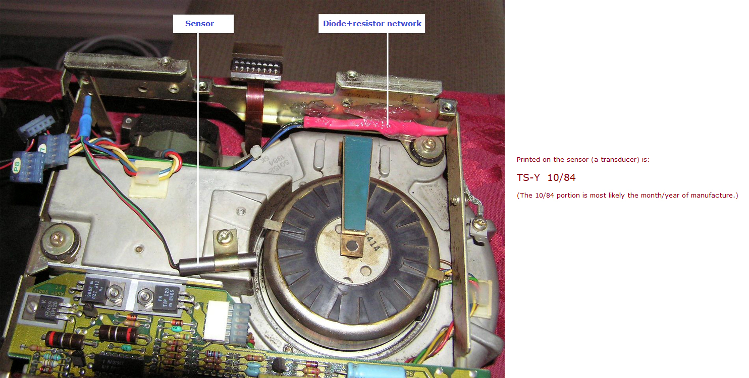

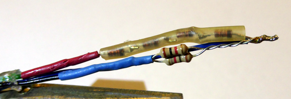

@modem7, how exactly have you modified your sensor?
By adding circuitry between the transducer (sensor, pickup, ...) and the circuitry that receives the transducer's signal.
We've been using the term 'pull down', but because the transducer is an 'active' device (i.e. fed +5V), it is more likely that the transducer is 'driving' the signal low.
I must point out that my particular solution was specific to my particular situation (combination of my drive's electronics and the nature/amount of the failure) - it is not a generic solution.
The 'correction' circuitry that I used for my particular situation is shown at [here].
Four diodes and a resistor. The diodes are standard 'small signal' ones.
The aim was to get the bottom of the pulse falling below the lower threshold voltage of the receiving chip.
It didn't matter that the high part of the signal also dropped - it just needed to be comfortably above the upper threshold voltage of the receiving chip.
Because I had a data sheet for the receiving chip, I knew what those thresholds were (and I knew the output pin of the chip).
For the count of diodes, and the value of the resistor, I had to experiment.
A photo of the circuitry is at [here].

When I manually rotate the interrupter until the arm is halfway in and spin up the drive, it travels back until it hits some end position, then flashes the error code
Now it flashes 1010 "Code A - Track Zero interrupter misadjusted" ...and it does look out of place.
