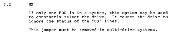

Working out whether the problem cause is in the drive, or elsewhere (cable or controller). The example of a Tandon TM100-2 is shown at [here]. The drive needs to be selected, and according to the M4851 OEM manual, that can be (easily) done temporarily using the MX jumper.

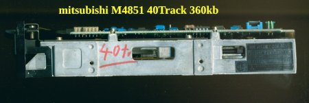

It is a pity that the OEM manual that @fritzeflink pointed to, does not contain a circuit diagram.
Does your drive match the photos of fritzeflink's drive, or is very close ?
I ask because of what I see in the bottom left of the third photo; the write-protect related component denoted as "WP". That is either the sensor or the LED, and considering the board markings of 'SG' and 'S', I figure that it is the sensor. The 'G' in 'SG' possibly means that that pin is grounded, supported by the thick trace, which can be seen to be heading off to the HM jumper and the screw. If so (sensor + SG is grounded), then using a multimeter, expect to see the voltage on the 'S' pin change when you insert a floppy. Maybe fritzeflink will confirm that behaviour on his/her drive.

It is a pity, would make things easier but my drive seems like it's an earlier revision since it does not have as much integration as fritzeflink's. Here are pictures of my M4851.

Don't forget, a dust bunny in the wrong spot will also cause this issue.
At a guess, in the lower left of the first pic, the red&black are the IR led and the yellow&white are the sensor. All the ones that I'm familliar with use phototransistors as the sensor. I think both the led and the phototransistor test like diodes.
