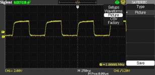

Captured waveforms
Captured waveforms

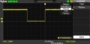

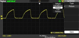

Hi,
I've captured some waveforms trying to debug the board. 6502_00_in is the clock in at 1Mhz. 6502_01_out/6502_02_out are the two clock outs. These are sawtooth in appearance. Is that correct? I've already swapped the 6502 from my Apple II+ one early on in debugging the PET board and it didn't behave any different so I thought the CPU was fine.
6502_00 in
6502_01 out
6502_02 out
6502_IRQ was taken when the computer was working. I noticed a slight right to left jiggle of the down transition when monitoring the IRQ pin, which you can see by comparing 6502_IRQ with 6520_IRQA image from the next post. I know those are from different sources but I'm telling you I saw a jiggle just like the difference between these two images while on the 6502 IRQ pin.
The 6520 CB1 pin shows the 60Hz hw interrupt SYNC signal which is maintained before and after the hang.
6502_IRQ
6520_CB1
continued on next post.
captured waveforms (continued)
Here is the IRQA from the 6520 chip (PIA #1)
I was concerned that I saw a right to left (time) wobble in the downward transition which *may* get worse as the machine is heating up. I'll have to do some more monitoring to see that for sure. Once the computer hangs the IRQ lines stay low of course.
I can capture and post any signal now so if you have any ideas, please let me know.
6520_IRQA
