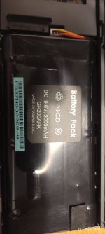

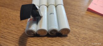

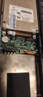

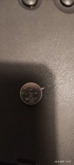

Good day. I bought a Nan Tan 9500 Dx4 and found your forum😁 I have a few questions. Could it be the original BR1225 button battery, really original? I already unsoldered it and now I'm thinking about a CR2032 battery in a yellow case. And then what about the main battery. It seems that it doesn't charge at all. Is there a similar one on offer somewhere? Which one can be bought?😀 Thanks. Michal.
And original storage batery.Thanks for yours reply.

Good day forum. I finished replacing the battery with another one. The bios was saved and then Win95 started, so the hard drive is fine. What is wrong is the floppy disk. It runs, but it doesn't read. It's a Mitsumi D359F2. Does anyone have a functional one? I would buy it from you. Another thing is the main battery. Now there are 1.2V 3800 mAh batteries for sale. They are the same size as the old ones, but they are Ni-MH. I will have to put a module in front of the battery to charge the new batteries. Is that right? Thanks.
Michal

You should be able to directly replace the NiCad cells with NiMH without much trouble. At worst, they might not charge fully correctly - you'll just have to see.
The floppy drive (if I remember right) has a belt-driven spindle motor, so you won't find a working spare. 100% of them will need new belts.
