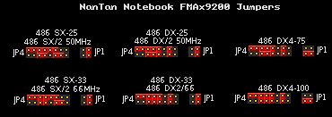

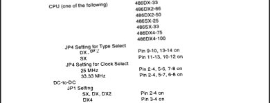

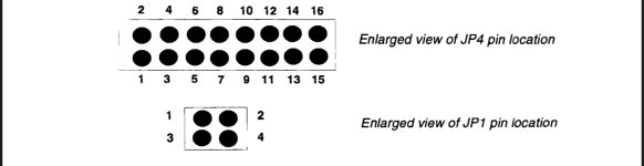

Awww, how much I'd love to have one of those! They seem like very nice machines.Seeking information from anyone that has a 9200AM/AD/AT. If you have any of these models with a DX2/66, I'd really appreciate it if you could post a photo of your jumper/dip switch configuration. I have a 9200AD that came with missing jumpers, no display, etc. After a reflow on the VGA chip and installing extra jumpers, I was able to get it to POST, but the DX2/66 is running at 50 MHz. I did try flipping some of the dip switches and was able to get it running at 80 MHz briefly. I'd rather run it at 66 MHz; I'm not sure how stable 80 MHz would be.

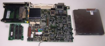

From looking around, it seems that the 9200 series had three different motherboards: 9200, 9200A, and a third I've seen in Tesco TN4 branded units.
