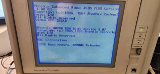

I've never seen this before. The text is physically too big to even display the BIOS messages without going off the screen! I've done some cursory checks of the dip switches and looked through the manual, but nothing jumps out. I have to put it in 80 column mode just to be able to use it at all. Does anyone have any idea what's going on? Is there something that sets the character size/height?
That is strange. My best guess would be the wrong LCD is installed or less likely would be a DIP switch setting (??) on the motherboard, but that's not as likely on such an old system. Is there an external video output? Is is also wrong?
If the DIP switches are correct (and not dirty/faulty), run the Setup disk and check the settings there. The "Hardware System Setup Guide" has mentions 40/80 column mode when you have the display set to CGB as display system
You know, I never considered that dirty dip switches would be a thing. Which is surprising because I use deoxit on my vintage stereo equipment and on connectors/card edges when putting computers back together. Not sure how I never put those two together. They are just switches after all!
I'm in the process of writing the setup disk to floppy now. I haven't tried the drive yet, so I guess I'll find out if it works lol. I did see some DIP settings for various display modes in the manual, but my understanding is that those only affect the external display. Unfortunately, I don't have a monitor that can do 9 pin RGB, so I can't see if the external signal is oversized as well. I really need to pick something up, but rural Missouri doesn't have a lot of great resources for vintage tech. Almost all I have has come from eBay, which is pricey. Anyone want to donate a monitor? lol
Huzzah! It was SW3. Mine were all "Off" which doesn't correspond to any of the valid options in the manual. Setting it to "OFF, ON, ON, OFF" as the the photo in the manual shows results in normal output. Thanks for the help everyone!
