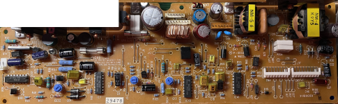

Thank you both for the help. I will begin trying the electrolytic, I think I should have all the sizes except for the really big one.
If I need to replace the gold / brown ones, are they still that colour and style today?
These are the ones I'm a bit confused on. I believe the blue is a ceramic disk, unsure on the gold and little brown types,
Thank you for any clarification.
Colour can vary.
The big brown one that I see in a photo of post #4 is a polyester type. See [here].
The disc shaped brown ones are ceramic. See [here].
Yes, the blue one is ceramic.
As for the gold/yellow ones, it is hard to tell from the photo, but do they look like the third capacitor (top row, third from left) in the 'Film capacitors' section of [here] ?
I've not really delt with capacitors other than small PCB projects, and especially stayed away from ones this size when fixing old computers.

Thank you for the links, I was actually on that Film Capacitor page earlier today and looking at that one! I did get better pictures just now with that capacitor removed and they do seem to match.small.pnggold.png

Hi,
I tested all the caps, ink is their marked value and the pencil is the multimeter readings
C80 would not give a reading. I cycled through the ranges incase the AUTO wasn't adjusting, but it was 0.00uf.
151 = 15 0 pF = 0.15 nF
The reading is explained by 0.15 nF not being within the measurement range of your meter.
Quote from the manual: "Farads from 1 nF to 9999 μF."
And 1 nF is the best resolution.
( Later, you may want to add a dedicated capacitance meter to your test kit. Its range will be much wider. )
I guess all components are important, but would this be enough to halt the power output?
Putting C80 aside:
For the ones that have three digits:
472 = 47 00 pF = 4.7 nF
104 = 10 0000 pF = 100 nF
222 = 22 00 pF = 2.2 nF
102 = 10 00 pF = 1 nF
473 = 47 000 pF = 47 nF
Based on that, nothing 'sticks' out to me.

Well I was hoping a capacitor was the issue. I have no clue where to go next. I will have a look on the motherboard and see if the + wire on the PSU contact goes somewhere else as it uses a different contact from what the battery uses. Maybe there's something there.
C80 has not been verified yet. It's position in the circuit is unknown, so criticality is unknown.
Capacitors have electrical properties besides capacitance. One is equivalent series resistance (ESR), and in some situations, that property is important. In switch mode power supplies (SMPS), there is often small-value aluminium electrolytic capacitors that support the switching/controller chip. Sometimes, in a faulty SMPS, one discovers the failure cause to be a small-value aluminium electrolytic capacitor - it's ESR has drifted over time to the point of affecting circuit operation, but it's capacitance can still be within the stated +/- 20% tolerance.
The 47 µF cap is pretty much spot on in capacitance, and so it seems unlikely to me that the ESR would significantly change without the capacitance changing also. In the photo of post #32, tape is masking part of the written measurement of the 100 µF cap. Take a chance, and replace both ?
There is so much that can go wrong in a SMPS. In the day, an area that I worked for sent faulty SMPS out for repair, because it was economical to do so. The repair company only charged if they fixed the SMPS. The company would have started off with basics like a visual inspection, checking the fuse, checking PN junctions (repeating our simple tests). From what we saw had been replaced, we worked out that the company was fixing a lot by doing a replacement of all aluminium electrolytic caps.
I have seen web sites that provide guidance on the repair of SMPS.
Yes.
If not fruitful, perhaps try putting a suitable resistive dummy load on the 20V PSU output (i.e. trying to prove the 20V PSU as the problem cause.)

I do have a pack of dipped capacitors on the way from Amazon.
The 100uf measured 102.
I replaced all the electrolytics except the large one.
I tested to see if anything changed.
Still nothing using the PSU in the PC
When using the charging setup;
There is now a louder hum, maybe a hiss. The measurement stops at around 8.xx. The LEDs on key keyboard are faint, yellow, green, red.
When the PC is turned off, there is still a hiss but faint.
I made a slight dent in the large capacitor trying to get it free from the glue, its not deep but figured I'd mention.
On try 2, no hum, constant -0.010 on the meter, nothing :(
