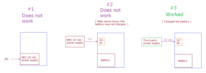

Good evening,
I have an issue with a PSU's and I feel I have gone as far as I can without direction or help from someone more experienced.
I'm learning as I go (with electronics) since starting collecting vintage machines, I began with a C64 with a black screen, have done some moding here and there and enjoy making PCB projects for them etc so I have acquired some knowledge but I'm still learning as I come across issues.
I'll try and give important details that may assist in a resolution.
The machine has a detachable PSU block that can be swapped with a battery.
To charge the battery, you remove the PSU from the machine and plug into the wall and connect a small AC cable from PSU to Battery.
The PSU takes AC100-240V and outputs DC20V 2A
When I tested the PSU, the output was only DC .06
The computer appears fine. I have a voltage generator and set it to 20V DC 2A, plugged it into the battery AC cable instead of the PSU and it charged the battery, and the computer turned on.
There appeared to be capacitor residue, no damage to anything but I changed those (330uf 35v 2x 390uf 35v) but they didn't solve the issue unfortunately.
I ordered a replacement NEC AC08F as a guess.
Nothing looks damaged or any signs other than the residue. The owner said it worked the last time they checked not long ago for what that's worth.
Any ideas why it's outputting a tiny DC voltage? fixable?

Having a look online, the third contact on the battery may be for the battery informing the charging circuitry in the notebook: "Something is wrong. I am overheating. Stop charging me."
If we look at the three scenarios below, I am putting my money on the NEC power supply.
An expected valid way of crudely testing the NEC power supply would be to load it using a resistor (or combination of multiple resistors) of an appropriate value. A value that draws 1A (half of the 2A max. rating of the power supply) may be good enough. (20V ÷ 1A = 20 ohms) (1A at 20V = 20W)
Alternatively, hook the opened NEC power supply up per #2 below, and within the power supply, measure the output voltage on the connector providing the +20 Vdc.

So with the lap top screen off (screen cable, 8 pin power cable and fan cable disconnected) I will hook up as #2 above. Failing anything I'll reattach incase
I attached a multimeter to the DC output poles on the PSU.
I noted its behavior
*started ~ negative 0.094 and stalled for a minute or so
*raised to ~ -0.084..83..82..81.. stalled here too
I wrote the message before this, took maybe a few minutes...
*It was now at 6v and climbing, pretty quickly with a ~.2-.3-.4 up ~.1-.2 down pattern.
*At around 10v a faint hum began.
*climbed to ~20 fairly quick and stayed pretty stable, occasionally dropping to ~18/19 once while dropped to ~16 but quickly climbed back up.
The "AC power" light on the laptop never turned on even at full 20. I'm fairly confident this would light with the battery charging/in use.
