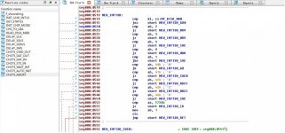

The boot bios is quite simple,it's 8086 instructions compatible.When it's been called by system bios as option rom, it replace the int 13h and int 19h with its own routines.
NEW_INT13H emulates hard disk with usb flash drive.
I think it is where the incompatible problems come from.
Some delay code:
Maybe delay code means to adjust cpu and usb disk?

Anyone who want to research the bios code or develop a new bios,I will send you the source code and my Ida pro disassemble project.

But what I really want to is making the old PC boot from a usb drive.The card's BIOS has some problems,it don't emulate hard drive properly.
Till now I can load a freedos kernel rightly ,but the file system seems not alright,the kernel can't find command.com on disk,so it stopped and wait for user input the path of command.com.I am still working on it,trying to fix the BIOS.As far as I know pearce_jj and pietja is working on it too.

After a little hack to the bios rom,I successfully boot my IBM XT from usb drive.The bios has a defult CHS value for hard drive,which is used to convert address from chs to lba.
What I do is change them to a reasonable value,former value set was strange.
Anyway after so many tries,we can boot from usb drive now.And all my usb drive will work with this card.
When I finish some tests I'll upload the modified bios rom.

This is the modified bios rom, it's not perfect but it may work in some situation.
I ran the Disktest.com writen by pearce_jj,but I don't finish the test,it runs for along time.
fdisk.com don't work with this card,it can't detect fixed disk.and if you use a large partition,dir command will take a long time too.
