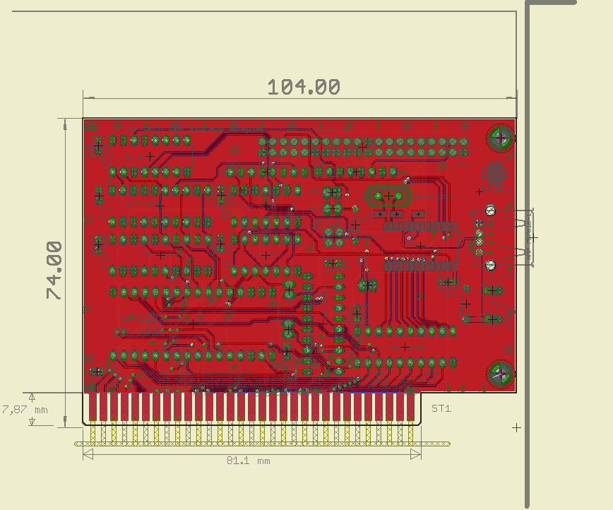

Some progress on this project, thanks to Malc and Pietja. The silk text is wrong and the CH375 is - on the Lo-tech r.1 USB board - listening at 2C0h. But it's working :)
On the Lo-tech r.1 USB board the connections to IC1 need to change to get it back at 260h if we want to

Yes rev2 will be back to 260 (perhaps an option). In the mean time we need to patch the ROM for the port change.
I believe the CONFIG.SYS line as it stands is: DEVICE=C:\DOS\CH375DOS.SYS @2C0 %2

Since the board seems to be basically working, I've gone ahead and laid out a rev.2 which allows for the connection of an internal CompactFlash module and external USB. This PCB will though be a little more pricey as it's 4-layer and much larger than the rev.01.
