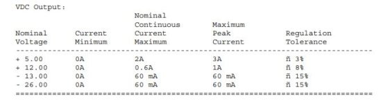

As far as the schematics go, I haven't found anything either. Best I could find was the technical service manual from the excellent minuszerodegrees website: https://www.minuszerodegrees.net/manuals/Compaq/Compaq SLT286 and SLT386s20 - Maintenance and Service Guide.pdf
The only really helpful information I could glean from that is it lists the output voltages of the internal PSU as follows:
Unfortunately, no information on which pins those voltages should be on. But it does show that I'm missing a -26v output somewhere. So that's something at least.
