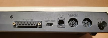

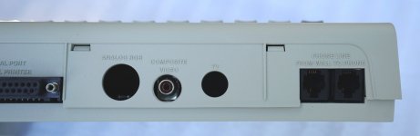

From the Ebay photo the case cut-out holes in the back for analog RGB and TV look empty and only composite seems to be populated. I am wondering if the PCB already has circuitry for those other video hookups. Know absolutely nothing about these. I believe they were used for point-of-sale roles since they have a supposed card swipe on the side, but with that 25-pin serial in back I am guessing they can be used as a dumb terminal with pretty much anything. Find out more when I get it I suppose.

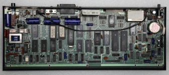

That's a little different on the inside than I expected. Looks like an 80C321 microcontroller for the main processor instead of an 1802 on the RCA VP4801. A lot more program space in EPROM too, if those are two 27C512 64KB EPROMs.

Its a 80C321. If my memory is correct, this is a ROMless 8051. It uses 8051 code. You should be able to disassemble it as Intel 8051 code. It looks to have a serial out ( can't quite make out the MC14xx parts ). There is a phone modem out as well. My guess is that the connector is for a CF card. Is the battery still alive?
