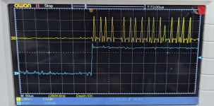

Put channel 2 on to the reset, and set the trigger to channel 2 and single then select the icon that shows a rising pulse. It will than draw a trace from both channels and stop.
Its going to take time to find the fault with just a scope, but I bet its still RAM which one of those little RAM testers would really help with.

Okay - fiddled with this triggering thing... fun!
The settings for Ch2 were AC and other stuff so sorted that out and it looks like what I think we're looking for..
and zoomed in a bit:

That's what you want to see. If this is consistent my recommendation would be to turn back to the DRAM chips and ensure there is activity on all of the outputs. You noted in post 69 that some of the chips didn't show activity. This is suspicious to me as all eight should show activity (especially since they're used in parallel).

EDIT: Your trace looks unusual in that the signal is consistent (symmetrical peaks and valleys). Here is what mine looks like (with a longer view than the first one). You do not not see a consistent repeating pattern in this trace:

Yes, regarding the uniformity of my trace as compared yours, I thought that too.

Uniformity of the CPU SYNC signal implies that the CPU is either (a) executing the same instruction over and over again or (b) the same instruction sequence - with each instruction taking the same amount of time - over and over again.
With your 'new found' oscilloscope knowledge (nothing like learning on the job - but you are learning...) does the CPU still go into the weeds after a period of time and you stop getting SYNC pulses or not now?
If the CPU goes into the weeds, you can use this fact (triggering on the leading edge of the SYNC pulse) to capture the address and data bus contents when it does go into the weeds. It still may not tell us much though - but may identify if a KIL instruction is to blame and (more importantly) whether this instruction was in ROM (or not) and (if so) whether the byte value in the ROM is correct or corrupt.
You would do this by using the other channel of your oscilloscope to probe the address and data lines one bit at a time when the CPU goes into the weeds. You will then know what the address and data bus were are the time of the last instruction that was ever executed.

So the presence of that SYNC is not consistent. Sometimes when I turn the machine on, SYNC will pulse for a short period (literally 3 or 4 pulses) then flatline. Sometimes 70, 80, 90 or so pulses, then flatline, but most often (probably 70% of the time) it'll stay pulsing until I turn it off.
The screen now seems to be consistently (between restarts) flashing black and white vertical bars now.
RAM activity seems the same regardless of whether there's a SYNC pulse or not.
I get RAM activity even in the empty sockets. Like Dout shows activity even though there's no chip in there. Further investigation shows the 3x Dout's in each column seem to show the same chatter (1 chip in, 2 vacant slots). Is that normal? Really need to read those books!

The sync pin goes high when the processor is fetching an opcode from memory and low when it is not. How it behaves depends on the instructions being executed.
Bad memory, either the ROMs or DRAMs, would cause the sporadic behavior. Since the ROMs are mask ROMs it's unlikely their contents would change between power cycles. The DRAMs would be different and likely power up with a different state each time.
