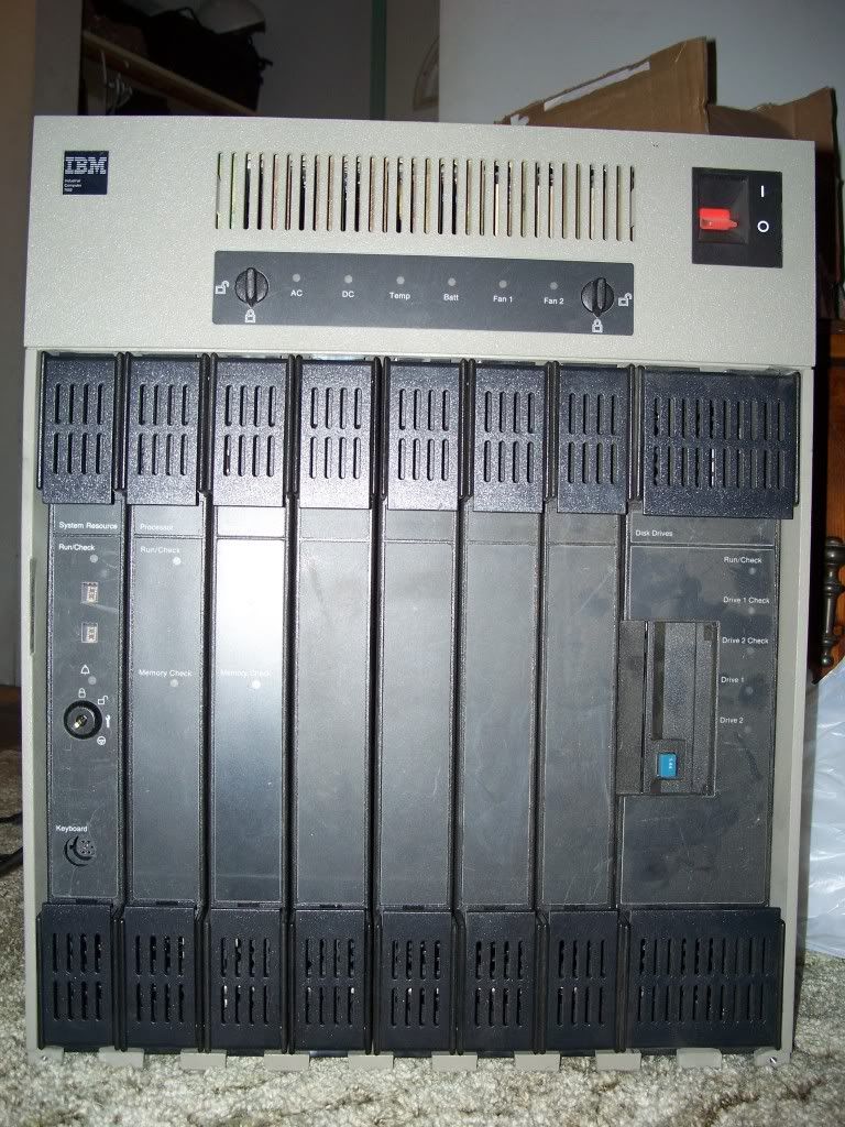

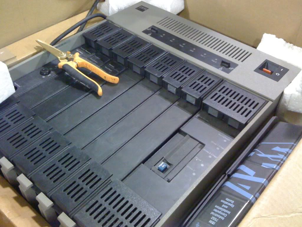

I was even shown a picture of the system at the recycling center where it was spotted.
It looks good. It's a Model 140 as it has the disk drive card (and if they pulled the drive I got PILES of those funky drives IBM had with the single edge connector) and there's manuals!

Is this thing complete? It looks as if there should be some sort of door or cover over the black area (where the metal shears are sitting).
I like rackmount cases a lot--put some feet on the bottom of one and you get a nice easy-to-access system with filtered air circulation that's easy to access and built like a tank.
I have no additional information on the system other than what I see is what I get.

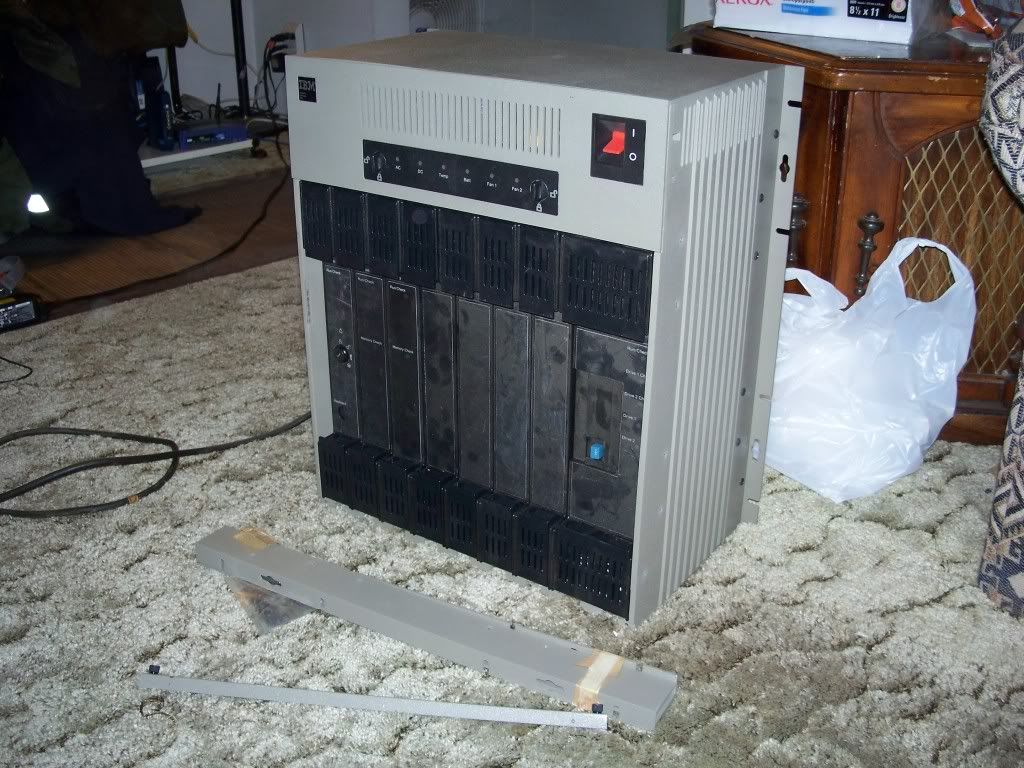

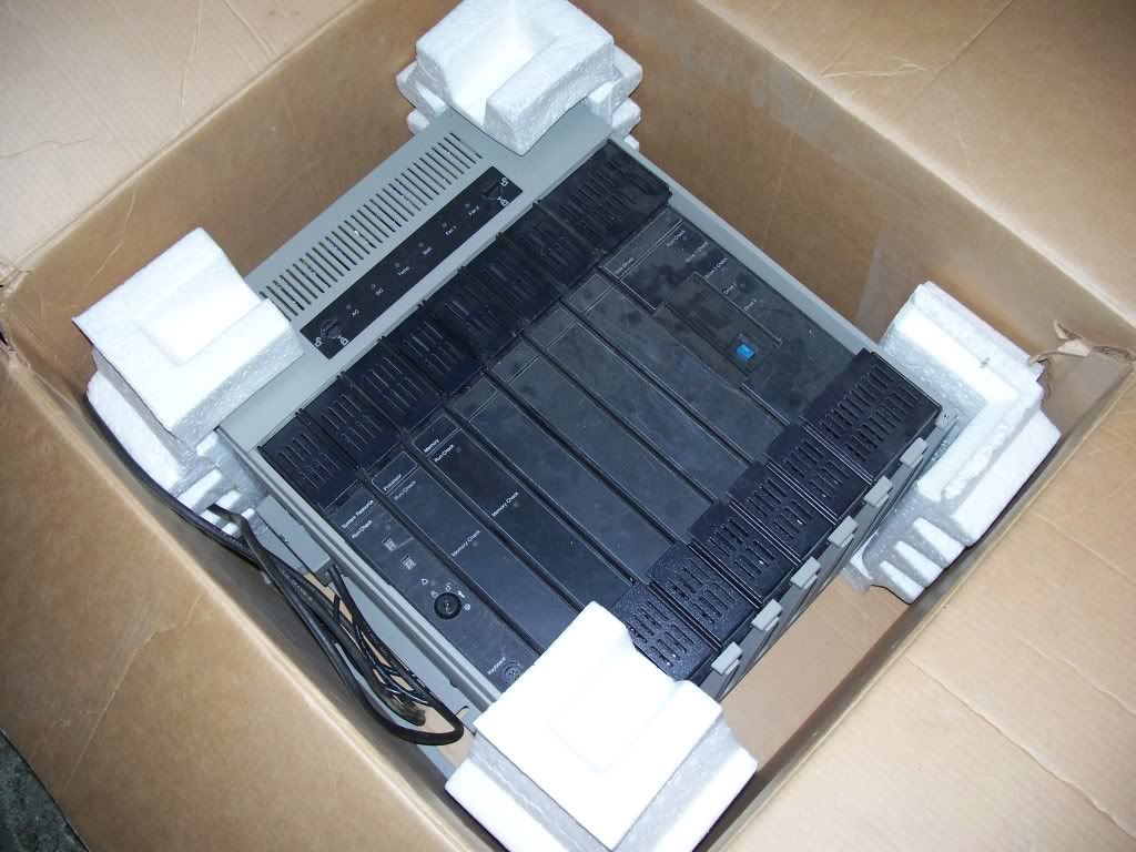

It's here and it's in a lot more impressive condition than I thought.
It was apparently shipped to Intermec Systems. This particular unnit was made in 1987. The hardware for a rack was included.

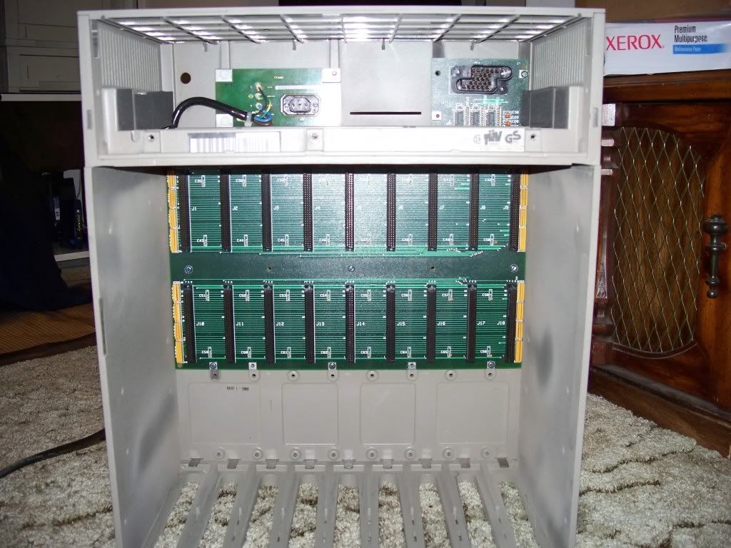

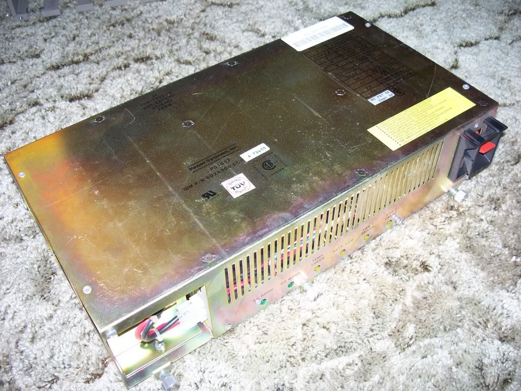

Everything in the thing is modular down to the power supply. it all runs off a single dumb backplane.
There is absolutely no Microchannel in this thing at all. It's totally ISA based.
There are five distinct modules in the system.

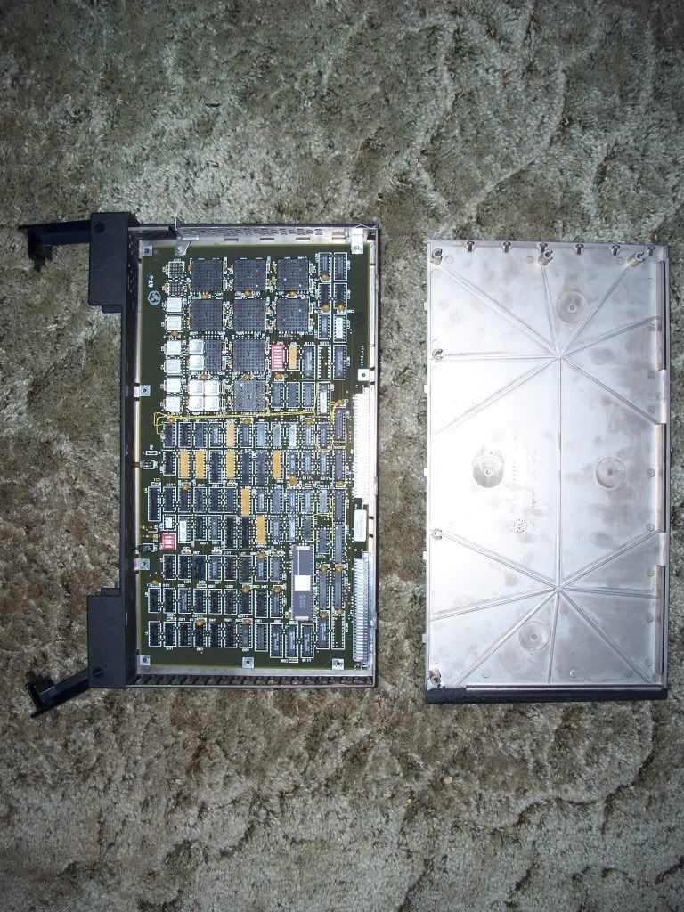

I/O

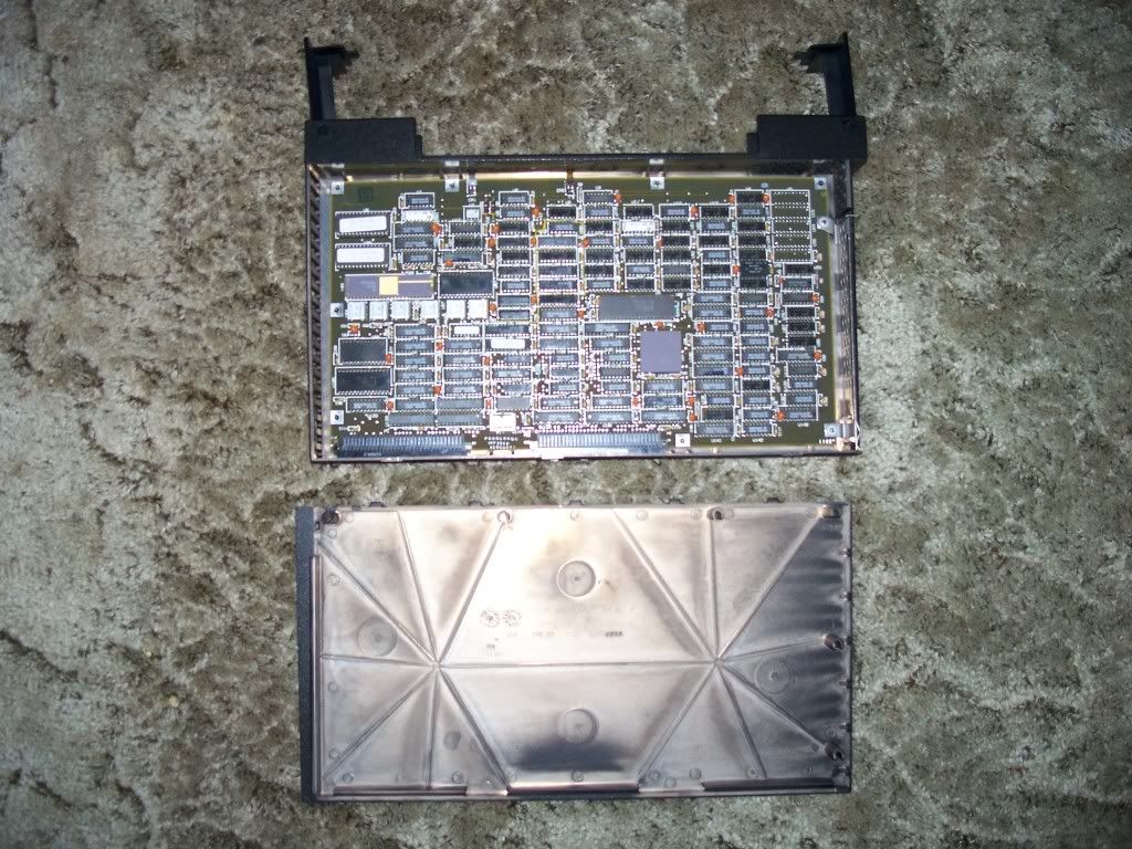

CPU (80286 + 287)

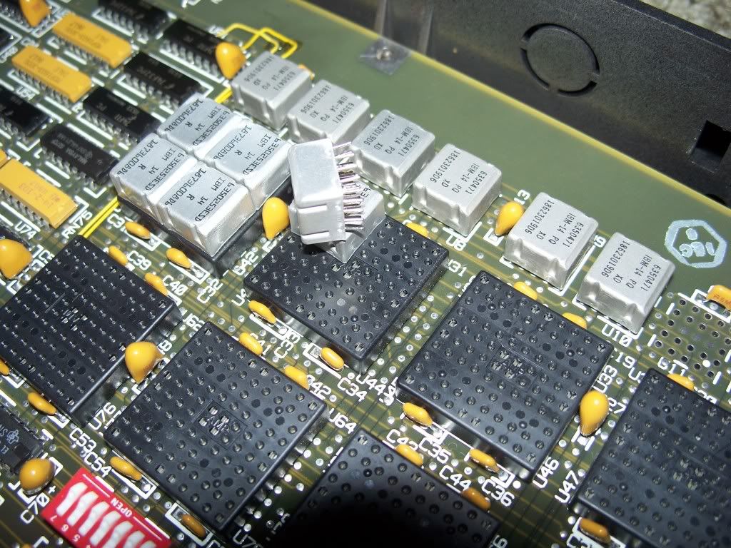

Ram
Well that explains why you could only do 3mb per module, it's so mad proprietary.....

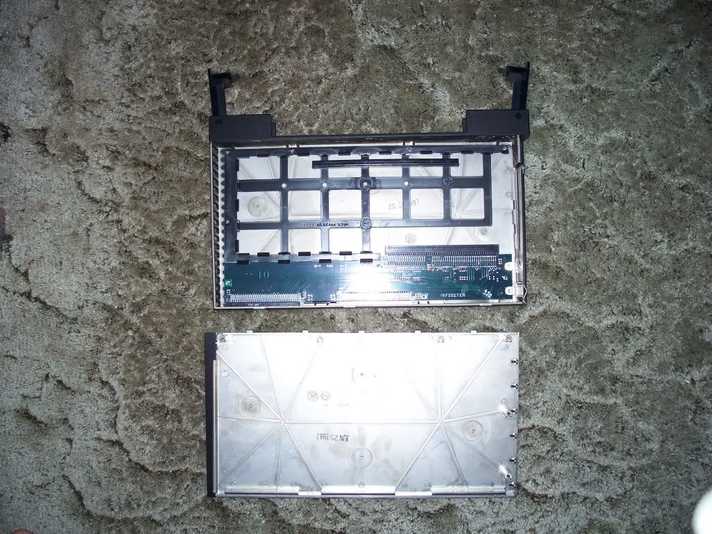

ISA
Seriously, it just adapts the lines on the backplane to an ISA slot. There is no magic going on in here and I got THREE of these adapters with room for one more.

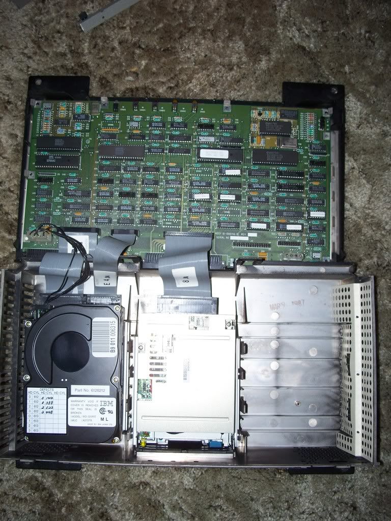

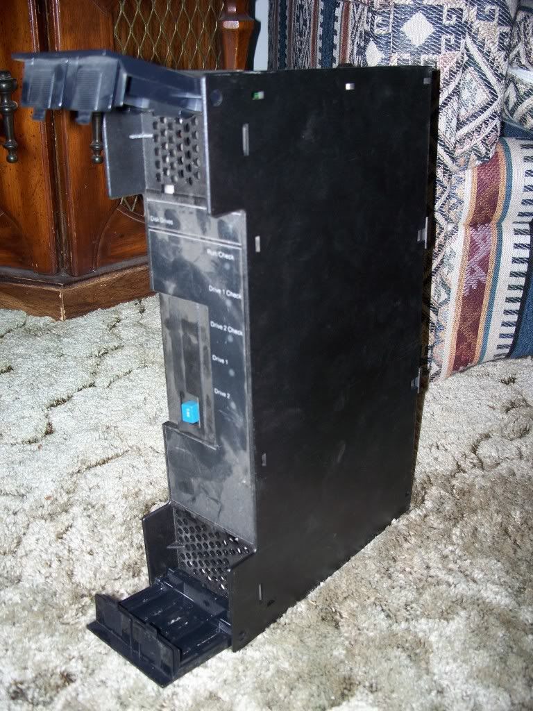

Disk
You option was for either a 20 or 40mb MFM drive it seems and you could support up to two of them.

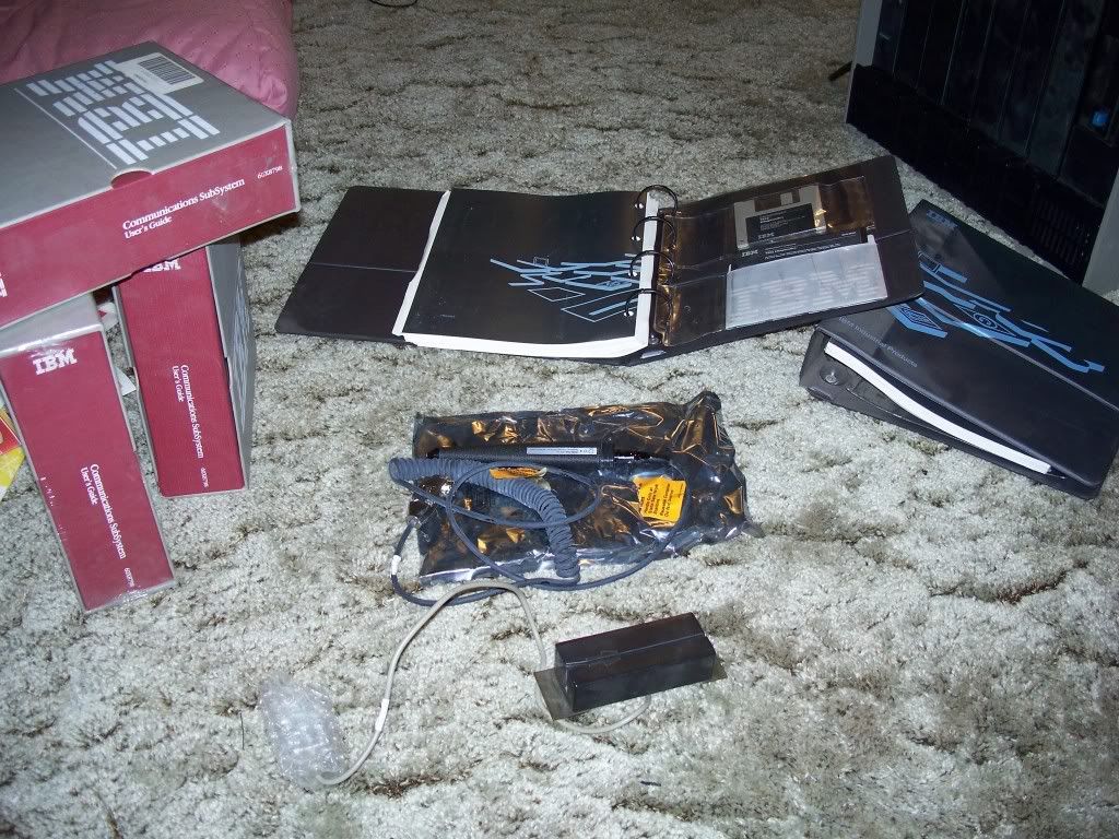

There was also more stuff too it seems.
I have three (two still shrinkwrapped) boxes of the communications subsystem (remote management?) software, two copies of the manuals (and diagnostics diskettes), a Magtek card reader and a barcode wand whose rubber boot has turned into an impossible to remove black sludge which is all over my hands now. >_>

That is just awesome looking... I took a few minutes to plug some numbers into google from the memory chips and lets just say, they came up with NOTHING. I would assume that any sort of memory upgrade is going to be hard to find and if the person knows what they have, expensive...
The memory looks like the metal tin cans found in proprietary IBM PS/2 model 80 RAM cards, will go look.
23 pin keyed RAM made by IBM (square cans 5 x 5 pin pattern missing 2 pins) looks just like the chips you have except there are soldered on so the leads are cut. Must be a few different densities since I just looked at 2 x 1MB RAM boards, one having 18 chips the other just 12 and I know cards were made with 2MB or maybe 4MB max.
