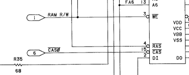

Follow the /CAS0 and /CAS1 signals back from the two banks of RAM. They should go to two (2) resistors.
/CAS0 drives the low 16K bank of RAM.
/CAS1 drives the high 16K bank of RAM.
Desolder one leg of each of the resistors that the /CAS lines go to and swap them over so that each resistor drives the opposite/CAS line that it was originally driving.

Dave on schematic i can't see resistor between cas0 and cas1 signal :(

Yes,
Desolder the ends of the resistors you have circled in red in post #173.
Then, wire the desoldered lead of R42 to signal /CAS0.
Then, wire the desoldered lead of R41 to signal /CAS1.
This swaps over the two banks of RAM.

I can't tell from looking at your picture. Use your multimeter (resistance) to find out which end of the resistors are wired to G7 and which end is wired to the RAM...
I see that the red circle on resistor R42 is connected to G7 pin 6, so R42 is the other end...
Look at the PCB for R41 to see which end is wired to G7 pin 12, and it is not that one.
i ma desperate because both R41 sides is wired to G7 PIN 12!! My multimeter sounds beep for every side of this R41 between G7 pin :(
The resistor is only 27 Ohms. Stop using the 'beep' function of your multimeter!
Use a low resistance setting - or just follow the PCB track from G7 pin 12 to the resistor. It is the other end you want!
