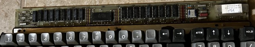

Here is the PCB of the 5110 keyboard, which is loaded with resistor packs (in groups of 10x on left, 8x @ center, and another 10x pack closer to the right side).
I haven't opened the portion below the keys themselves -- I assume that's just contacts of some sort, no PCB content. Unfortunately didn't get a clearer image of the PCB here while it was out, but this is the general gist of the component layout.
EDIT: I'm still trying to wrap my head around it -- if the main system is "supplying" 5v on the keyboard connector pins.... Somehow the ICs on this PCB are re-directing that, so that the system then gets 0v on those lines (as appropriate to whichever key was pressed)? via a different ground than the ground pin of the keyboard connector? (er, maybe not... there is no other explicit cable to the keyboard, but there are 4 mounting bolts that could be grounds).

If the engineers at IBM were anything like their contemporaries, the signals between the keyboard and system unit are "open collector". That is, resistively tied to +5 and pulled low by logic needing to signal. Many MCUs with 5v tolerant I/O can be configured as "open drain", which works fine (the STM32 "blue pill" is one of them).
Keep in mind that pull-ups may come in the form of a resistor pack, which could be what those tall, thin components are.
Ah, hadn't considered that. And to clarify to general public: sometimes those tall/thin components are tilted ~45deg, sometimes they are straight up; evidence of these parts being "hand assembled" as opposed to stamped out by machine/factory.
I'll also add that when a signal line is unidirectional and open-collector, totem-pole drivers can usually be employed on the signaling end without any problems. Both sides should share the same power supply rails for this to work.
When doing CPLD and FPGA work, "open collector/drain" is often done by manipulating the tri-state control line on the output, which also works. In other words, logical false = high impedance; logical true = totem-pole low. You can also employ totem-pole outputs with isolation diodes in series to the same effect.
