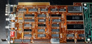

Perhaps there's a version problem. I run an XT clone with a Trantor MA13B and external ZIP. I use MA13B.SYS and TSCSI.SYS; works fine under DOS 6.22.
I have run a similar setup on a '386 machine, using most of the same hardware. I was beginning to suspect the adapter, but -
mirabile dictu - I resolved the issue; a configuration problem. The answer came from one of the many sources I investigated online. It turned out that adding "LASTDRIVE=J" to the top of the CONFIG.SYS file resolved the conflict. I don't know how many drives DOS 6.22 is prepared to address by default, but apparently fewer than this.
A: and B: are floppies, 16 GB Bigfoot is partitioned into three 2GB partitions which are C:, D: and E:. The Everex RAM drive was being assigned F:, but I had disabled that in my attempt to figure out what was going wrong. ASPIDISK.SYS was announcing it had installed the ZIP as F: but when I would try to access it I would get a "general fault" error.
Next I tried running IOMEGA's GUEST.EXE from a floppy (B

. Once again GUEST hung the system, until I found this nugget (below) and edited the GUEST.INI file to reference C:\SCSI\ASPI2DOS.SYS, the driver the Adaptec install wanted to use for the 1522A. You can see that the default INI does not have a value for that, which would explain the system hang. Too bad there was no error generated, though.

With that modification GUEST ran, albeit with everything else in CONFIG.SYS disabled, and I had a drive labeled F:. I was unable to read the disk I inserted but got an error stating "invalid media", not general fault. I switched to a disk I had used and knew was good, and got a directory listing. So far so good.
Next I tried allowing CONFIG.SYS to identify the drive. Once again the ZIP disk was recognized and assigned label F: (the RAM drive still disabled). Finally I un-commented the RAM drive reference and it installed as G:.
Nothin' to it.

MEM /F reports:
Free Conventional Memory:
Segment Total
00C67 80 (0K)
00F40 96 (0K)
00F46 88,992 (87K)
02500 502,784 (491K)
Total Free: 591,952 (578K)
No upper memory available
The Everex 125 card was able to backfill conventional memory but I have not figured out how to backfill upper memory. When it creates the RAM drive extended memory is used. I haven't been able to LOADHIGH, in other words.
