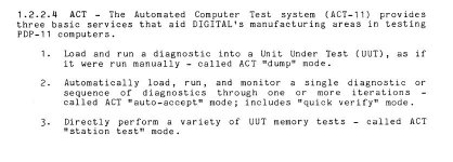

Basically correct; I was referring to the specific code sequence: JSR PC,(R0) back to a monitor (where R0=contents(42)), and the use of locations 42/46/52, to return back to a monitor (XXDP+ in diagnostic chain mode) as well as what DEC manufacturing used in their ACT-11 (automated computer testing) system.
From the DEC diagnostic design guide on bitsavers:
Basically the control system was (in my experience) an 11/34 with several RK05 drives, and a custom UNIBUS switch. Each port on the switch connected to a UUT system via UNIBUS, so the ACT system would essentially DMA diagnostic images into the memory of the UUT, launch them, and then monitor them for pass/fail. For each type of UUT system a preconfigured script of the diagnostics to run was provided on the ACT-11 system. Basically the operator would plug a board into the UUT, power it up, and enable the tests to start, which would run unattended, producing a pass/fail report at the end. Pass means ship the system, fail means back to debug station.
When I was at DEC in the late 70s I was with the PDP-11 diagnostic group and went down to the DEC manufacturing site for the 11/60 in Aguadilla, PR where I helped integrate the 11/60 diagnostic test process into their ACT-11 system.
I think what Marty is doing is a bit different, developing a test jig to allow direct control/observation of all the I/O pins on the card edge connector to facilitate benchtop testing.

Don: Thanks for the explanation regarding the ACT-11.
It sounds then like the "UUT system" was a full PDP-11 system of some type (else how can there be a "UUT system console"?) into which one plugged the actual UUT module? So in Marty's case the "UUT system" would be an 11/45 and one was doing module-swapping?
Then ACT-11 was a fast centralized system to load/initialize a set of "UUT systems" with XXDP diagnostics. Have I got that right?
paul
paul
ACT-11 was for system testing, not module testing. The central ACT-11 CPU (like an 11/34) had several local disks (like RK05's) that contained all the diagnostic image .BIN files. The ACT-11 monitor would download diagnostics to the target system via direct DMA thru the UNIBUS, run them, and then monitor the pass/fail result thru the in-memory mail box data structure.
There was a board/cable that plugged into the UUT backplane that basically was all the UNIBUS signals, plus some out of band control signals like INIT, AC LO, DC LO, etc that allowed the ACT-11 system to remote boot the diagnostics.
I am familiar with ACT-11 testing racks and racks of PDP-11/60 CPU boxes and local memory. No local storage or other peripherals involved.
