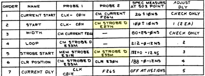

Some success with the PDP-9 yesterday. I went through the Control Memory (Microcode) timing checks in the System Adjustment Manual. To change the CM timing you need to unwrap and rewrap wires on the backplane to configure delay lines. This was done at the factory when the machine was built, and the configuration in the schematics may not match a particular machine due to manufacturing tolerances. The timing was close enough, so I left it alone.
