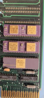

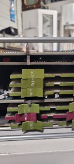

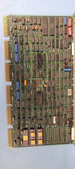

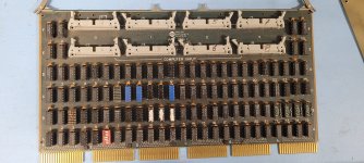

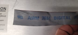

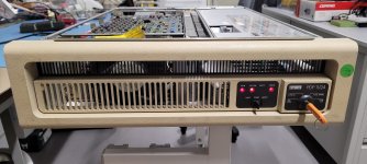

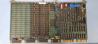

I started working on a PDP11/24, first thing to do is taking it apart, document all boards and take out the power supply.
Then I will open up the power supply, to check all the capacitors.

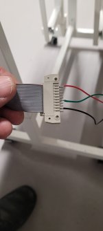

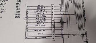

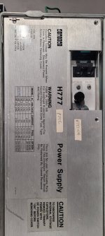

I’m using this 😀👆🏻Schematic and those 😃👇🏻 Power supply connectors.
And I have no load connected to the power supply and I’m measuring strange voltages, is that because the lack of drawn current, or is the powersupply defect?
/PUZZLED/
Normally I test these things with a few car lamps on it. Not all old switching power supplies can work without any load on it. 24V bulbs are fine for every voltage, they are just a bit dim. The same is for a 12V bulb on the 5V.
Regards, Roland
I'm sure this is not a switching power supply.
And I even think that the connectors are not wired suggested by the picture
The H777 +5V regulator looks like a crude switcher. The base of the pass transistors Q1 & Q2 is transformer coupled through T1. The current through T1 is controlled by Q6 which is controlled by the 555 timer E3. My guess is that the frequency of the 555 timer is controlled by the output of the op-amps E1 & E2.
The power supply in the PDP-11/05 has a similar design.
FWIW, in my (rather limited) experience with a couple of these, an H777 works fine without a load and C5 (3900 uF @ 6 V) seems to be one of the more common failures.
Found my pictures from fixing my H777 in my 11/34. Caps caps caps...
And yes, it is a switcher, no doubt...
