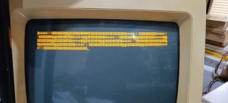

Have a M8650-YA card that keeps having problems.
So far I mange to get a bit going.
Program 33 of the Toggle (Echo test 03/04) perfect, no problems, also when a Key is pressed continues there is no failure in the print out.
The AC is showing correctly the typed Char, f.i. A=0101. All tests with all kinds of Key's, char, as well as numbers , Capslock etc. they all print correctly.
The prog 32 (Char Print test) just rubbish as a print out, Also the AC does NOT increment, but shows the same rubbish.
The prog 31 (Print Char put in AC) does some correct, and a pattern of failure is to be seen.It repeats the pattern with the same failure.
Now I am trying to figure out and localise what part of the M8650 should be at failure.
-Think RX and TX buffers are OK
-All at the right side of Buffers (RX and TX) part must be ok due to at ECHO test the sent receive is correct.
-RX-TX Address selection paths are OK, as card reacts on control lines and ECHO prog is working.
-X-TAL is OK (even changed it out)
- RX-Decoder E43 had a failure and has been replaced by a 7442(conversion done)
Seems to be a kind of timing issue, or out of sync.
But why is it running ok with prog 33 Echo-test, when I keep pressing a key, and that keeps printing correctly.

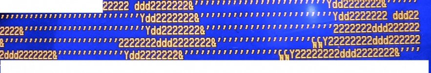

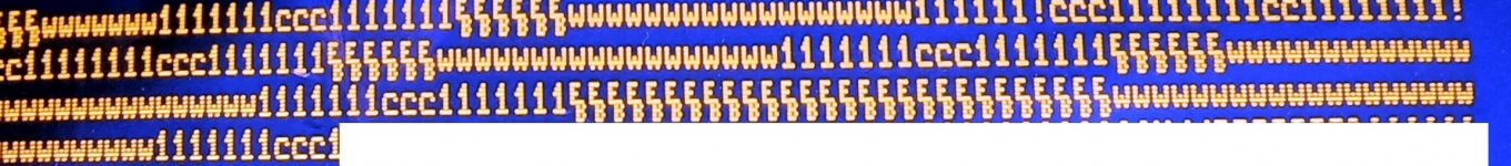

Here what I get With prog 31 Print AC
Char "A"
This With Char "B"
This with Char "1"
This with Char "2"

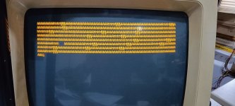

This is the Char Print prog 33

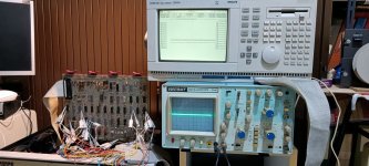

Also Digged out my Analyzer PM3585. I never used it properly, so have to learn the machine still, but some basics I know.
What Clock should I use for the timing of the DATA bus DATA04-DATA11,
Or the Clock to be used for MD09-MD11

So char A display I, B=>J, C=>K, D=>L

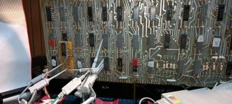

Think I got it. E20 2nd FF, The Start FF, Never becomes '1' At the red line, Clock UP, Input is alway's '1', Clear is '1'(in active) So output 8 should follow input that is '1'.
Looks like you figured it out. Way to go! Seems like it is often a failed 7474.

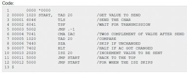

Those results are the expected behaviors. In the first program we start with the AC being zero and it stays zero. In the second program we start with the AC being all 1's and it stays all ones. It does not seem like the AC is being modified. How about we get really paranoid and we go back to the original program only slightly modified to have it check that the AC is not getting changed by the serial port IOT instructions.
 1       0000 *0000
 2 00000 1020 START,  TAD 20          /GET VALUE TO SEND
 3 00001 6046         TLS             /SEND THE CHAR
 4 00002 6041         TSF             /WAIT FOR TRANSMISSION
 5 00003 5002         JMP .-1
 6 00004 7041         CMA IAC         /TWOS COMPLEMENT OF VALUE AFTER SEND
 7 00005 1020         TAD 20          /COMPARE
 8 00006 7440         SZA             /SKIP IF UNCHANGED
 9 00007 7402         HLT             /HALT IF AC GOT CHANGED
10 00010 2020         ISZ 20          /INCREMENT VALUE TO BE SENT
11 00011 5000         JMP START       /BACK TO THE TOP
12 00012 5000         JMP START       /FOR WHEN THE ISZ SKIPS
13 $
Essentially the same program but it will tell us if the AC is getting changed from what we want it to be. Will halt on an error. AC will have the difference. LOC 0020 will have the value that was sent. You can set LOC 20 to whatever you want the initial pattern to be.
If this runs without halting then we know the AC is not being modified and what you are seeing in the display while the program is running is something else. And it should look the same because 99% of the time is spent in the TSF wait loop with the AC set to the desired value. The 8 or so microseconds per character sent where it isn't the value probably can't be seen in the display.
If this runs, then the assumption that the AC is being changed is false. And I was making this assumption based on what you said about the display not appearing to increment. What baud rate do you have it set to? at 9600 baud you would only see counting in the upper bits of the AC, AC0 through AC5 or maybe AC6. The rest would be changing too fast to see. At 110 baud you would see counting in all but perhaps AC11.

Any way I probe that E33 and E44. With prog 32 Print AC no action of E44 and E33 C0 and C1, signals keep the same during run Prog 32 AC increment,
With Prog 33 the lines C0 & C1 are activated.
Also I made a 5x STOP argument probe on C0, and indeed after 5x Keypress the Analyzer stops.
Then indeed C0 & C1 are activated as seen in the picture.
Prog 32 no activation of C0&C1
Prog 33 Echo 03/04 test

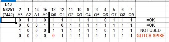

Took Clock from Output E34 that is in line of I/O Pause
See E33 fith from left already been changed SN7401N (new old stock)
E43 N8251 (convert to 7442 but probe is at N8251 pinning)
It is following the truth table
Wave form is at a Terminal Keypress 'A' and C0,C1 are following.
There is a Glitch spike to '0' at output E43-13 =Q0' (
But probing the E47 output Its still '0' due to fact input E47-5 is 1.
E47-4 output is only '1' when both inputs are '0' So the spike has no consequences.
