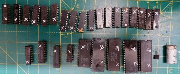

Good jobQ8 went OC... replaced transistor and its working again.
Some of the memory replacements I ordered from China arrived faulty the MM2114N-2 chips.
