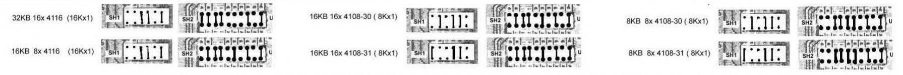

EDIT it definitely has 8 x 4106's, can someone please attach a photo of that ram-size jumper block so i may check? Mine looks a mess, someone surely has messed it up... Might explain why its only working as 8k.
There are two "shunts" as they are called on the board that set the memory configuration; one is 6 way, the other is 10 way.
Take a look at this thread : http://www.vintage-computer.com/vcforum/showthread.php?41167-PET-3016-memory-upgrade
Giovi (user giobbi) posted the (attached) diagram which shows the correct shunt settings for different memory configurations. They are the same as the ones on the schematic on zimmers. Actually, I'm thinking of taking my shunts out and wiring links on the board - it would look much neater. I've had to modify them from 16k as 16 x 4108 DRAMs to 16k as 8 x 4116 DRAMs and although it is electrically correct, the shunts do look a bit crap.
Cheers
JonB
PS, Good news on the toolkit. Very useful with a "bit o'BASIC", I'm sure!

Be careful with these shunts. You might go from 8K to 0K. Remember most games work properly with 8K. With power off, use an ohmmeter to check continuity of the jumpers. They should be set for the 16K configuration. If jumpers are OK, then you might have bad RAM in second row. If you are not good at soldering, think twice before trying to unsolder the chips.
There is a trick called "piggybacking" that you might try one at a time on the chips in the second row to identify a bad chip before unsoldering any of them.
The Palo Alto IC ROM called BASIC Programmer's toolkit is in the UD5 socket which is the 4K address space B000-BFFF. Have you found the proper schematic page for the ROMs?
