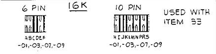

I noticed on the layout schematic there is this thing called Detail B which shows alternative track layouts for some configurations. Do I need to alter them for 4116 configurations? There are three positions on the board labelled Detail B. They are currently not cut (refer to the detail B diagram) attached.
As I read it, you only need this for 8k models, but I thought I'd better check.

So now, what about the purpose of all this hackery, the 32k upgrade? I checked the shunts - I thought all I had to do was link H and I'd be sorted. So, one blob of solder and 8 4116 chips later, I'm firing it up again. Ooops! Got the garbage screen, and it's not clearing. Better recheck those shunts - I should have opened M as well! I opened it up and again checked they were correct - a bit more carefully this time. All good.

I did continuity check the shunts, both times, but I'd misread the 32k setting of M=open so I had left it closed when I first installed Bank 2.
