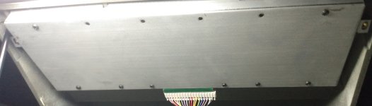

Im trying to remove the keyboard for cleaning, but it's not coming easily. First off, it doesnt look like any CBM keyboard that I've ever seen, nor does it match the examples in any video on the subject. This kb is in a sheetmetal case with 12 black screws visible. It lacks the mounting tabs typical of CBM kb's, as seen on a VIC or 64 - and apparently most PETs.
When I try to remove screws, some come out relatively easily. But most seem to bind hard, only increasing in torque as I attempt to turn them. The removal torque is excessive, as if they are Loctited.. And I can't even tell if they are retaining the metal kb case.
Thoughts? I don't want to damage anything.

Those tabs you mention - they don't have any screws in them, at least not right now.
However, the (2) short #10 screws that hold the hinged case closed do pass through the holes in the tabs to reach the threaded inserts in the upper case half. So maybe the tabs provide a little extra security to mount the kb, but beyond that I don't see their purpose.
And that keyboard is VERY securely mounted. Even with several of the black screws removed, it shows no tendency to flex or move.
That’s kind of the point with that many screws. ;)
(again, see my edit about disregarding the thing about the side tabs being the main support, it had been a while since I’d opened my PET and apparently got it crossed with how Apple II keyboards are supported on the short sides.)
It should come off when you get them all. The only thing to worry about here is if somehow the screws are so corroded and sticking so hard that you manage to damage the plastic posts they’re going into. If you hear cracking noises and turning the screw no longer backs it out you have problems.

Yeah.. when I applied force and turned one of the tight screws, I heard & felt something that may well have been a cast-in threaded insert slipping in its case boss.
Yuck. If those screws are actually seized in their inserts, this just became a big, ugly problem.

There aren't any threaded inserts in there, just self tapping screws.
The "plastic" is structural foam which is brittle so it will sound rough.
On one PET I had to replace the keyboard screws with a slightly larger size since they were stripped out.
I usually re-assemble WITHOUT the metal tray. I believe that's only there as shielding for FCC compliance. It's heavy and cumbersome to re-install.
The screws that are coming out look like #6-32 machine screws, not the sort of wide-pitch, pointed 'wood' screws I'd expect to see if they were threading directly into plain plastic bosses as used in 64 / VIC etc,
That, and I've never seen screws stuck this hard in plastic..
But hey, we'll see! This is uncharted territory for me. Good news is that I got several more of them out.. only three really stubborn ones remain.

And the keyboard function is restored..
All it really needed was a cleaning of the switch contacts, though to look at it you'd never have thought there was anything to clean off. I used medical swabs (the ones with long wooden shafts, not Q-Tips) & Energine fluid to clean both the PCB contacts and the dark gray conductive rubber tips of the key plungers. Isopropyl alcohol 91% might have worked, but I tend to go straight for the chlorinated solvents - they are the source of true power.
(Energine is just a brand name for 1,1,1 trichloroethane cleaning fluid. My can is 30+ years old, and I'm not sure if it's still sold - but most chlorinated automotive brake / electrical cleaners are the same or similar stuff.)
