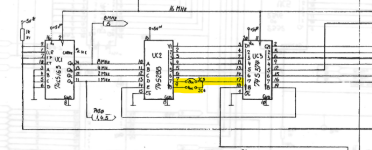

An idea came to me, tell me if it's crazy or is it possible in some way, I checked the faulty PROM and confirm what was reported in the videos previous to this post, I then checked PIN 9 of UC2 and saw that the signal is correct but for 40 columns reported on schematic diagram jumpers J3 and J4 attached, it has two negative pulses with a different frequency instead of just one negative pulse i aspected, I could somehow take the output signal from PIN 9 of UC2 and transform it into what I would need for 80 columns which should I have it on PIN 7 of UC2?
I suspect (internally) that the logic for the output pins 7 and UC2 are somehow 'intermingled'.
Internally, pin 9 will be whatever is on pin 7 divided by 2.
It is easier with logic to divide by 2 than to multiply a frequency by 2...
>>> Ok, in this case i have to divide or moltiplicate signal on PIN 9?
You have to MULTIPLY the frequency of pin 9 by 2 to give the same as on pin 7. I.e. the difficult solution!

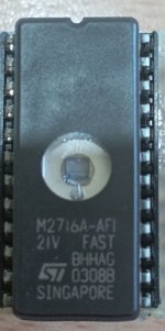

Second test, i have burned a ST2716 market as FAST on top, with this the machine boot, i have Commodore screen and ready but with cursor in a wrong position, is all to the right of ready and i have a blank square in the bottom right corner, keyboard working and machine respond to the command but cursor stays in the right.
With all other type of 2716 or 2516 the machine not boot or boot with garbage, but cheeper is present and correct.
This is confirm the speed problem of EPROM, i make other test with this fast 2716 model, i have to check if the adapter made is ok or not.
I have also 2732-45ns but i don't kwnow if i made modify on the adapter for this.
If it is a -45 EPROM it is actually 450 ns.
Please check the data sheets for the parts to determine the actual parameters from the part numbers.
This is the model with machine boot with the cursor problem.
