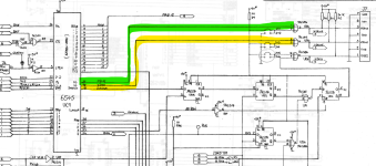

If you have problems with the link get back to me. The documentation is in there - so please read it...
The fact that you start to get the chirp implies that the Kernal ROM has entered the EDIT ROM successfully.
The 'truncated' chirp (and the potential CRTC programming issue) could indicate a faulty EDIT ROM.
The PETTESTER will yest this theory out...
