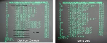

I have looked at the ASM DEV PAK.d864 and compared that to the Zimmers software package , see attached images. The one I have been using from Zimmers, I think is a "doctored version" of the original disk . The reason is that when the Editor, Loader and Assembler programs are run, the Commodore copyright text and program version does not come up and also the names of these programs have been altered with dots, instead of dashes, that match the manual file naming.
Also I couldn't make the high loaders work on the Zimmer version at all, so there might be errors in it. Somehow, when company programs get tampered with, no matter with good intentions, there always seems to be a quirk added.
In addition, the Zimmers disk has a "Universal Wedge " on it (it works) but the original disk/s has two Fast Wedge programs, 4.1 and 4.2.........I wonder if that was intended for BASIC 4, or it is just a program name? I ran this DOS wedge on my PET it appeared to work.
Also on MikeS's disk, there is an interesting copy disk 2.0 program that appears to be set up to copy between two different disk drives (I'm sure I read something recently that this was difficult with the PET, maybe this program solves that ? )
This may explain the problems I have been having with the zimmer version. See message #45. I will try Mike's version on Steve's site.

Mike,
I think the hard copy I have and the floppy was sent to me by yourself so many rears ago I can't remember when! I should have used the floppy with my 4040, but I took the other route of using the zimmer .d64 image on VICE. I have had a lot of problems getting it to run correctly. I will switch over to your version and try that image on VICE. I am thinking the zimmer version is an old buggy version or a corrupted version as Hugo believes.
