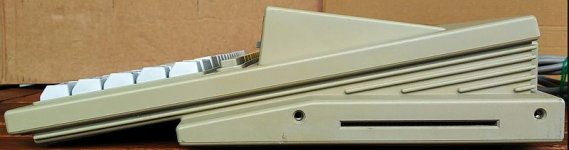

I would love to test it in my Olivetti Prodest PC-1 (Nec V40, 512 kB RAM) but I doubt that it would fit in the ISA slot at the right side of this keyboard-PC. The ISA slots are a bit deeper in the housing so an ISA card would require to have a bit longer contacts as usual ISA cards.
This is an example of modified XT/CF from an italian vendor for Prodest PC-1, he cuts out the red marked corner to be able to plug the card deeper in the right side ISA slot of that computer.
Here you can see the ISA slot of that neat PC. Olivetti offered an expansion box fitting here in good old times, having 128 kB extra mem, XTA harddisk and one ISA slot.
