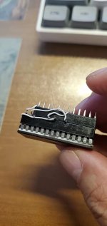

I also tried to use 27C64 to replace the ROM chip and built an DIP28-24 adaptor. It still failed.
28-24 adaptor connection (red pin number were connected each other):
Please help me to find out the problem. Thanks!
