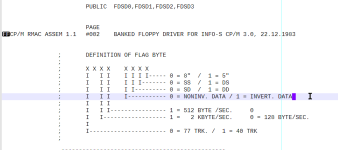

I have a lot of 8" floppydisk to read and thought that's no problem as I have the format definitions in my archive
and 22disk will do the work.
No - I got an error from 22disk
* WARNING? * Two files found to use same diskette block
-- You may be using the wrong disk definition Block: 0002, File: BCHARIO.ASM
An other problem is that the format is complementary (?) and only Anadisk with his [F7] is a small help.
I have a German software 22disk which even doesn't like to open the floppy directory. That's horrible as I haven't thought about such problems.
My format definitions are for SS and DS:
BEGIN KRA2 Krause 2 ECB CP/M3 - SSDD 15x512 8"
DENSITY MFM ,HIGH
CYLINDERS 77 SIDES 1 SECTORS 15,512
COMPLEMENT
NOTE SKEW 4
SIDE1 0 1,2,3,4,5,6,7,8,9,10,11,12,13,14,15
note SIDE1 0 1,5,9,13,2,6,10,14,3,7,11,15,4,8,12
BSH 4 BLM 15 EXM 0 DSM 281 DRM 191 AL0 0E0H AL1 0 OFS 2
END

As I could read a lot of files I now have a source and the format definitions from *FDC.PRN in the KRAUSE.ZIP file.
Making images with IMD is no problem (included in krause.zip) but as the format is 'complement' I have no chance to
see what files are directed to the same block.
DPB2 DPB 512,15,154,2048,192,2 ; 8" 77 TRK DS DD
0022+3C00 DW ??0033 ; 128 BYTE RECORDS PER TRACK
0024+040F DB ??0034,??0035 ; BLOCK SHIFT AND MASK
0026+00 DB ??0036 ; EXTENT MASK
0027+3902 DW ??0037 ; MAXIMUM BLOCK NUMBER
0029+BF00 DW ??0038 ; MAXIMUM DIRECTORY ENTRY NUMBER
002B+E000 DB ??0039,??0040 ; ALLOC VECTOR FOR DIRECTORY
002D+3000 DW ??0041 ; CHECKSUM SIZE
002F+0200 DW 2 ; OFFSET FOR SYSTEM TRACKS
0031+0203 DB ??0042,??0043 ; PHYSICAL SECTOR SIZE SHIFT

Yes, I can see that the data is NOT-ed, i.e. all 1 bits swapped to 0, and 0 to 1. So I can recognise DIR entries, and the first byte that should - I expect - by 0 for User 0 shows as FF.
I can easily write a little QB prog to flip all the bytes in the file, so that the data can be viewed correctly.
If that looks OK, then another QB prog to read all the DIR entries, and verify the DIR re ALLOC blocks, and answer at least 1 question, is theImage OK, or does the problem come from the original or the image process.
As Chuck suggests, maybe the problem is one of the 22DISK format parameters? But not easy to tell from the data now!

Yes, the image file is perfectly readable now. Esp re the Dir sectors (apart from the interleave making it's own complications) Alloc blocks look OK, but the DIR data starts with block 2, that means blocks 0 and 1 for directory. Need to work out how many sectors per block and see if numbers tie up. There's a fair bit of empty DIR space.
Geoff
The various parameters seem to tie up, apart from the bit mentioned.
AL0 shows E0, which indicates that the DIR has 3 blocks, and this agrees with the 191 DRM. And everything ties up with the 2k Allocs.
BUT, the first file in the DIR shows it uses Allocs 2, 3 and 4. But 2 is part of the directory? Although there are not enough files in the dir that the dir actually uses this space!
Also, the first file in the dir is BCHARIO.ASM, 4992 bytes, which is just over 2 Allocs, so it needs 3, which the DIR says it has.
this file is present in the unloaded listing, shows 4992 bytes, and looking at the file it has a reasonable-looking start, middle and end. So seems to be complete.
I'd try change the 22DISK def to DRM = 127, and AL0 to C0, i.e. the DIR space is 2 allocs not 3.
Chuck - is it possible that 22DISK woild read the file anyway from Alloc 2, even though this is really the dir space, but give a warning re defn being wrong?
Geoff
I'm not exactly sure that E0 is the correct for AL0. Should be C0 by my reckoning. Let me make a real disk (in uncomplemented form and have a look at it.

The disk we've been looking at has about 70 files on it, not all the files in the zip were on the disk. A couple of the files are bigger than 1 extent (i.e. HELP data) but still 70 something dir entries. So the 128 reduced to will still be OK.
BUT you say you have a number of disks to check. Is it possible you might have some with one format, and some with the other? Take care of that. Can easy change the format back to the original settings. Those settings change whether Alloc 2 is part of the dir space, giving 192 dir entries, or part of the data space, with 128 dir entries. Or amend the DEF file for 22DISK to create a new entry

What is curious is that with ANADISK I see that the directory is block 0 and 1 = 2x2048/32 = 128 dir entrys.
From the PRN the DPB was made by DRI MACRO the info of DRM=191 but may be false as there are only 2 blocks for DRM
and even ALOC can not be E0 as this are 3 blocks which isn't schown by ANADISK.
Maybe the source isn't identical to the images ?
