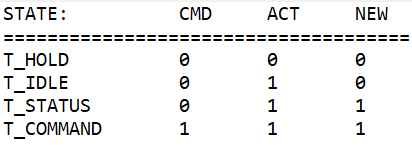

After my test experiences with the AMD PAL example by Doug Kern, I have become more interested in 286 CPU cycle control and decided to look into the Intel cycle model further.
I hope that recreating the original Intel model may enable me to experiment with partial functions being covered by the 82284 and 82288 while trying to take over others one by one with the System controller CPLD. The more control signals I am able to take over, the closer I will be to replacing the 82284 and 82288.
So in order to do this I will need to design a new state machine which runs in sync with the original Intel "double cycle per CPU state" model.
When studying the Intel datasheet timing diagrams I am seeing some difficulties which are not noticeable in the AMD timing diagram. However since I measured similar behaviour by the CPU before as seen in Intel's diagrams and diagrams of other support chip manufacturers, I am leaning more towards those being accurate.
In the Intel diagrams, the S1 and S0 status output pins of the 286 CPU are changed by the CPU asynchronous to the clock cycle period boundaries. That means that sampling them precisely at the clock boundaries will be useless to transition the cycle machine in some cases because at those times they will not reflect the changes yet which we are interested in.
In my attachment below I tried to illustrate this. At the state cycle boundaries(red lines) the changed state of S1 or S0 is not fully established, this occurs outside of the boundaries. So switching from T_IDLE to T_STATUS exactly at the cycle boundary will be impossible because there is no way I know of to decode before hand if the CPU intends to lower S1 or S0 a moment after the cycle boundary.
Depending on S1 and S0 for exact timing, looking at the timing diagrams, is not a good idea, so I need to choose different solutions for detecting these events.
Additionally, I had a closer look at the CPU state diagram as supplied by Intel, while evaluating this also looking at the 82284 pins, the 82288 pins and taking into consideration that we also have a T_HOLD state.
I want to design the state machine slightly different from the typical method. Normally this method would say we have 4 states so we need 2 state machine bits. But for my purpose I feel it would make much more sense to reflect the actual situation with three bits. This in the hope that later, perhaps less decoding logic may be needed. If that works out or not, I will keep this method for now unless there arises a need to change it.
So I decided to create a state machine using 3 bits. Below in my attachment you can see a table of the states and the three bits reflecting each state. The bits are called CMD, ACT, and NEW.
Since there is a need to make an asynchronous adaptation of the state machine, what I will try to do is to always transition from T_COMMAND to T_IDLE as soon as the wait state period is ended by READY being asserted low. Also exiting from CPU hold will always transition into T_IDLE.
The reason for this is that at T_IDLE, during the first quarter of the state period, between the green lines in my diagram, I will sample S1 and S0. If one of these goes to zero, which is the indication by the CPU that it intends to start a new cycle with T_STATUS, I will then immediately transition the state machine from T_IDLE to T_STATUS, asynchronous to the clock. So there will always very briefly exist a T_IDLE state in any case, until S1 and S0 are ready to be sampled which can enter the state machine into T_STATUS. If the CPU doesn't start a new cycle, the state machine remains in T_IDLE until the full state cycle has completed and another sampling of S1 and S0 can occur. The state bit NEW indicates the instance that the CPU has started a new cycle and exited T_IDLE. So switching to T_STATUS is slightly asynchronous, I don't see how else I could do this and I believe that it will not be of any importance, and possibly even done in some similar way by Intel. Unless I am missing something else.
The state bit CMD indicates that the CPU is transitioned from T_STATUS into T_COMMAND. This bit will remain active during wait state state cycle repeats until READY is sampled low so the state machine can return to T_IDLE, where S1 and S0 are sampled again.
The state bit ACT specifically can indicate if the CPU is active, or in T_HOLD. This is controlled by sampling CPU_HLDA during T_IDLE which would tri-state the command outputs and then further transitions into T_HOLD at the next state cycle boundary. T_HOLD is maintained until CPU_HOLDA is asserted low, which at the state cycle transition will always cause the CPU to enter T_IDLE either briefly or for an entire state cycle period.
So that's my concept for now. I am not sure if it reflects Intel's method, however I hope that it may be accurate enough to be able to predict in next design steps where which control signal needs to be activated.
I will look into designing all the state transition logic next. As soon as I have a concept of this, I will share the schematic here.
So there are three design steps ahead:
- functional design of the state machine
- design the command decoding
- design the command and control output logic

I have made some substantial progress. After some tweaks to the state machine logic and the logic which connects it with the other System controller logic, it now looks like the state machine is accurately following the CPU state activities according to the Intel state model.
So I proceeded to work on the ALE signal. During this work it has become apparent that these recent updates are really testing the limits of the CPLDs used. The specified speed of the CPLDs is 10ns. And I am working with clocks of 31.25 nanoseconds. Certain logic which is theoretically sound is apparently not being triggered at these speeds.
I finally managed to create a circuit to generate ALE using the T_STATUS condition of the state machine. Using the dual channel cheap portable LCD scope I could see that the ALE test signal generated by the CPLD was nicely following the original one coming from the 82288. So I proceeded to put a socket between the 82288 where I removed pin 5 and changed the ALE input to an output on the CPLD. Then I connected the new circuit to the ALE net in the CPLD and updated the System controller. After the update I saw the PC come alive right away and it produced the POST screens, however during boot time the PC froze. So it appears something was not 100% in sync(yet) and during boot time this becomes apparent. I tested by going into MR BIOS and I was able to control the BIOS and go through the menus fine without any freezing while leaving the PC in the BIOS screens.
So as a test I decided to change the logic to decode from S0 and S1 directly from the CPU. This event to generate ALE is during the second clock phase anyway so S0 and S1 will be well established by then. This worked even better and I was able to fully boot the PC using the new ALE signal, and I have run a Wolf3D demo for about an hour without any issues.
I will do some further modifications to try to improve the accuracy of the state machine control of ALE, possibly I can still get it to work using the state machine timing. I am thinking to sync the different command states another time and just using a state signal which is active when a particular state is active. Possibly this can produce even more precise timing and could keep the ALE signal running properly controlled by the state machine.
After I am done with ALE I will continue with other control signals in order to attempt to replace those. A next candidate is the DEN signal which is internally decoded by the CPLD. This could possibly free up an extra CPLD pin which I could use for other purposes later.

My thanks to sqpat, he sent me two CPUs which he has verified, one Harris which he clocked up to 32.5 Mhz and an Intersil which he got up to 28Mhz, pretty amazing speeds! The fact that he has verified those CPUs makes me 100% sure that these CPUs are not fakes, which is very useful in my work to have this certainty that at least the CPU should be able to run at high speed. I am currently using his Harris CPU in all my tests, rated at 20Mhz, but which can go up to 32.5 Mhz.
I have found a few issues in my state machine which follows the CPU operation states. Somehow the T_COMMAND state is not entered and exited.
So the machine only goes between the other states, which is not a complete function yet.
I need to fix the issue in the state machine and verify it with some signals for reference to make sure it follows the CPU correctly during all the states.
Later I will be testing the T_COMMAND state against the wait states I observed before when monitoring DEN during the memory read cycles.
Another issue I am having is that the ready timing is not entirely right. The READY signal is too early so I will need to clock and shift the ARDY_n signal to more closely match the READY signal coming from the 82284. I am trying to find a complete and correct description of the READY operation. When READY is working right internally in the CPLD, this also will help the CPU cycle state machine to operate correctly since this is also based on READY being a part of the cycles, to predict the wait cycles, exiting from T_COMMAND, etc.
The timing inside the 82284 is weird, they shifted the PCLOCK by 2/3 of the CPU_CLK. This appears to be synchronized to the timing of the CPU controlling S0 and S1 at the start of a transfer cycle. So I think there must be some programmed delay on the 286_CLK internally to achieve this time shifted PCLOCK. The timing is strange because it's 2/3 off compared to the 286_CLK, which is a weird amount. This timing is not so useful for other purposes, and not used for anything in the IBM AT design.
I will keep at it to try to assemble a complete "bus control" replacement so I can eventually remove the 82288 and 82284 from the mainboard.
I am thinking to at some point insert a FPGA into the system, and try to let the FPGA take over some functions.
My idea is to let the FPGA generate the clock to the CPU for example, this can make testing the system much more flexible.
And I am hoping that the quality of the clock will be higher so I can get a better synchronization of the CPU to the clock.
Eventually I want to test with a FPGA memory subsystem and perhaps even provide the ROM data from an FPGA in some faster way.
If I can replace a lot of logic with an FPGA this could reduce board space a lot, and provide faster speeds in the system.
So this way I hope to be able to reach zero wait states without any issues if the DRAM controlled by the FPGA can keep up.
I have studied some FPGA types which are 3.3V compatible like the Cyclone II, which is even able to interface with 5V systems using some resistors to limit the current into the "PCI clamp diodes" which are enabled with 3.3V operation. I saw some affordable small PCBs with 128 pins on the headers for example.
I also have a Spartan-3 starter board with 3 40pin headers, I will look into how I can possibly put this to good use for the project. This one is by Xilinx so I will need to look at what tools are available. This board does have some RAM included.
For now I will keep working with the CPLD because it's already in the system, and try to expand the functionality by replacing the 82284 and 82288 control.
