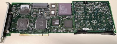

So now I think the most convenient OS would be a Linux version. But what is the latest I can run on this system? Back in the nineties I played with Redhat 5.2. But I wonder if the Smart SCSI array controller is supported at these Linux versions.

If you use Linux, make sure you use the SCU to configure the BIOS so it is in "Full Table" or Intel MPS compliant mode. (if you don't have it in the BIOS, you may need to get some old Compaq SmartStart CDs)
Thanks a lot for all the tips and suggestions! I will try to get it up and running.
All the batteries on the RAID card are still okay but I had to replace the bios battery
on the motherboard. I replaced the old battery with a CR2032 socket and battery.
I have Smartstart 5.5 with the machine, so I can configure the machine and RAID controller.
