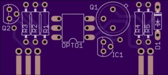

Ordered the 20 mA loop receivers today:
This is the one that uses a large metal can 2N2905. Current source is now temperature compensated.
I updated the 24V switchmode loop supply board to use a full wave bridge rectifier. Not ordering more prototype boards of that yet, since the basic design is fine.

Protoboards for the receiver are in! Assembled:
As you can see, I've soldered 0.1" breakaway headers to this one and stuck it directly into a solderless breadboard. That was part of the design goal for modularizing. There's a 1 Ohm resistor in series with the loop converter for current measurement. The two 3.32 Ohm resistors in series are like that because I didn't have a 6.64 Ohm resistor on hand.
There's plenty of room for a "tophat" style heatsink on the 2N2905A. It gets warm at 24V loop voltage with basically the loop voltage directly across the receiver -- loop resistance equal to whatever the power supply's resistance is, plus the 1 Ohm sense resistor.
TTL output is provided by a NPN inverter, logic 0 is around 90 mV and logic 1 is around 4 V. Sources 3 standard TTL loads.
