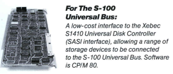

I have a Xebec the S-100 host adapter for the S1410 like shown in the ad photo posted by ahend.
I have attached Xebec's documentation for patching CP/M and their .ASM code.
There is a contoller like mine on eBay now. The seller does not know what it is, so it is not listed corretly. eBay link
Marvin
Fantastic Marvin! Hardware is only half the battle.
Are you sure that host adapter on ebay is a copy of the one you are using? There is so little information how would contend with the switch settings?
The eBay listing is identical to my adapter other than the fact that mine has a grey pin header. You can see Xebec's part number 104616 in one of the photos. I am not sure why Xebec did not put their name on the host adapter. Perhaps they didn't actually manufacture it. Anyway, no doubt that is their adapter.
