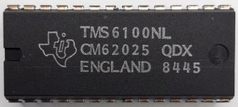

The BBC Model B has by default, 2 empty sockets for TMS speech chips. One of the spaces is for a TMS5220, which is the speech processor. The other is the so-called Phrase ROM, a TMS6110 chip. The Phrase ROM contains (obviously) the phrases that get processed to ultimately emanate from the loudspeaker. Other contemporary devices used the same pair of chips to generate speech.
I am attempting to read and save (to file) the contents of a TM6100 Phrase ROM chip using a BBC Model B.
I'm using the ReadPHROM program on this page:
The content appears on screen but I am not familiar with the BBC and have no idea how to save the data that scrolls past to a file. I expect (hope) it's something obvious that BBC users know about.

It worked, sort of. The program outputs some other stuff onto the display though - it includes the byte address on the left and also the ASCII representation of the hex on the right (much like an HxD screen or similar), so what should be a 16kb file is actually 79kb odd and contains a lot of padding. Looks like I'll have to see if I can amend the basic prog to only actually show the hex part on the screen. Nearly there though.

No, I'm not clever enough. I did manage to remove the spaces, and remove the address part on the left and the ASCII readable part on the right. That generated just screens full of hex codes. Great. But when I save it to file the result is an ASCII file and when opened in a hex editor it shows the hex codes for the text and it's a complete muddle. And as it thinks each 2 digit hex number is ASCII it also gives it 2 bytes in the actual hex section, so the file is therefore exactly 2x the size it should be. Here is what I mean (the 'Decoded Text' is spot on, just in the wrong place (you know what I mean)):

As you appear to be using HxD I believe you can simply paste the text into a new file and it will convert to binary.

Aha, yes you're absolutely right! New blank file and pasting it in is now spot on. Good tip that, thanks.
No need to make any changes to the original program file Dave.
It's not a BBC PHROM, it's the PHROM from an ICL OPD computer, which I don't think has ever been read/dumped before. I was just using the BBC as a convenient way to achieve that.
Part no. is CM62025, which is on that list as unknown.
Now it's known! There was also a version of the ICL OPD for the USA with a different voice that sold in very small numbers, so potentially one of the other unknowns not too far away in part number order will be for that one.
ROM dump attached.
