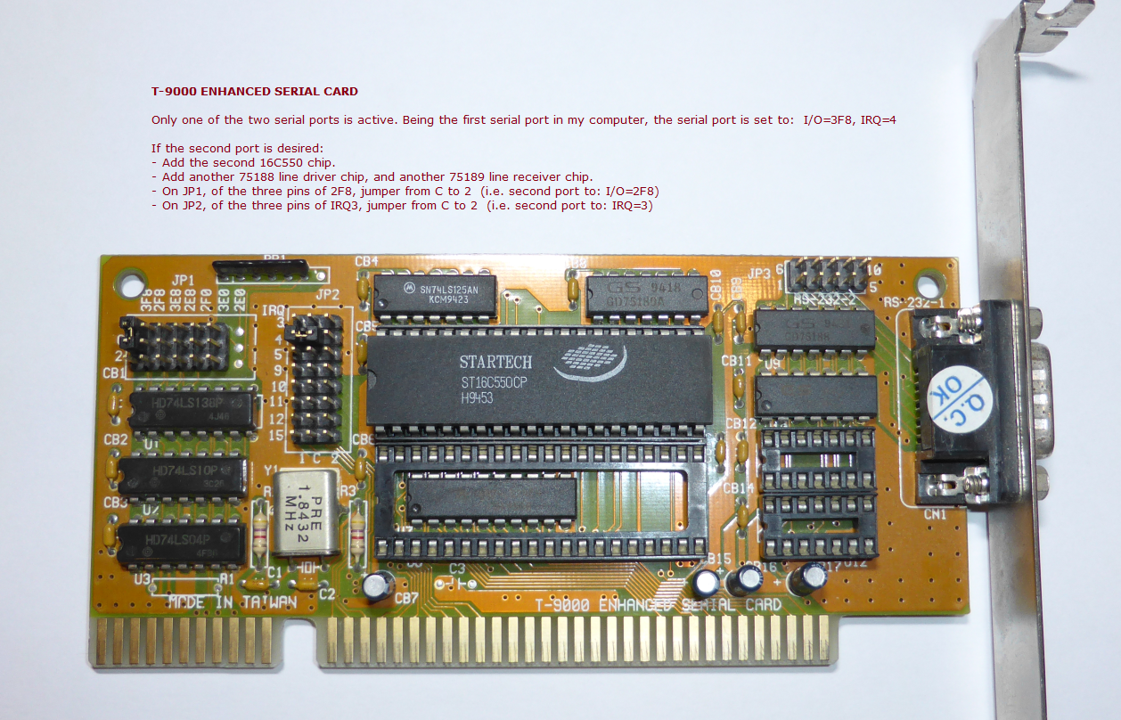

I found the card, which I picture at [here]. Set as: 3F8, IRQ4.
I added it (as the only serial port) to one of my IBM 5170 motherboards (an 8 MHz one).

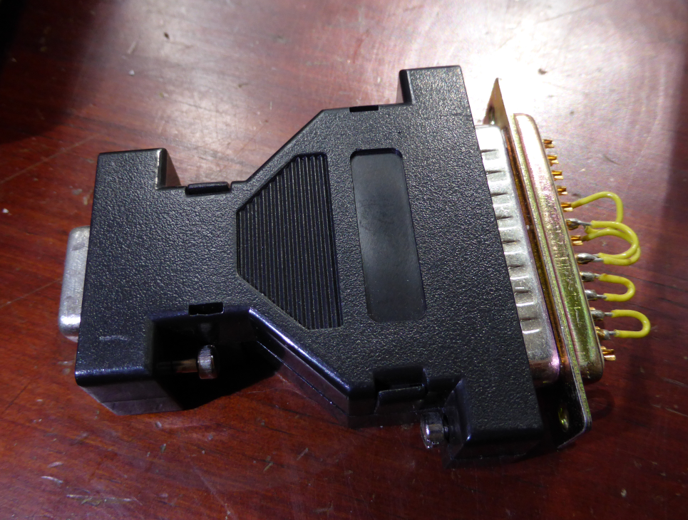

Via [this] adapter, I hooked up an external loopback plug to the connector, a loopback plug that is compatible with both CheckIt 3 and SERTEST.
On the IBM 5170, I booted to DOS 3.3
All tests in SERTEST passed, and SERTEST reported that IRQ4 responded when SERTEST executed code that got the UART to generate an IRQ.
I ran the serial port test in CheckIt 3, answering in the affirmative when asked about an external loopback plug. That serial port test passed.

To be clear about the internal loop mode, it’s basically doing the same thing as the external plug but internally, IE, it acts like a null modem cable connected to itself. If the UART passes the test in internal loop mode but doesn’t send characters in real life then the problem is probably the EIA drivers, not the UART, since that’s the thing that’s going to take the hit from a short or something. (I’ve seen one of those chips with the magic smoke brutally liberated, it happens.) If you want to know if the card works full path why not either just:
A: use one of the external loopback plugs, or:
B: if you have the null modem cable already, just use a COMM program to type at yourself between the machines?
Either of those should work to give you an accurate answer.
