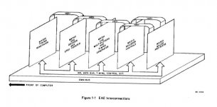

But.... the real prize came at the bottom of the box. A set of M8340/41 EAE cards. The M8340 has a stamped AUG 13 1974 on one side and a circle sticker OCT 75 OEM on the other. The M8341 has a stamped DEC 30 1974 on one side and a the same sticker on the other. Looking at these cars, there needs to be some over the top connectors on these cards, but only two of the line up. The M8340 has a spot for two connectors at the two left positions and the M8341 has two spots but in the middle of the card. How are these cards supposed to be installed in the machine?
I told my buddy, I owe him and his wife a Sunday breakfast. Christmas in April, after all it did snow this morning.

I found this. Apparently the timing board is first, then the 8340/41, then the major registers.
I want to change out the filter capacitors prior to pluggin the boards in and then I can try the MAINDEC programs for the EAE. This time it will mean something. Mike
