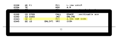

While I am going through the process of getting the code listed in the App Note for the 38.4K Data Terminal from National Semi, I came across this bit of code. In Z-80 mnemonics it is a LD A,nn. But the code says '03h' but the listing shows '1E'. And the line of code contains 'XOR 01Dh' which doesn't fit either. Looks like another head scratcher for me. Anyone have any ideas, or point me to the 'error of my ways'.....

If I had an actual brain, I'd be very dangerous.... I looked at that many times earlier and never saw it. I just did again; once I changed the 'XRI' 8080 mnemonic to the 'XOR' Z-80 equivalent.... Curious now how/why it was written like that, and how it actually assembled.....
03 xor 1D = 1E
in other words MVI A, (03h xor 1dh)
