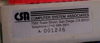

Hi, David. I have one of these, also in a HP briefcase, but mine doesn't work and no display comes up. I bought it at a flea market many years ago, but just pulled it out of storage and was looking around for info and found this thread.
The power supply looks OK, and if I disconnect the SBC the display lights up and responds to keys, so it's probably OK, too. But it looks like I only have one of the PETEBUG PROMs and two copies of the TUTOR U11 PROM, so I could really use a dump of the PETEBUG pair if you get a chance.

I have One of these and am in California
Mine is missing the 8751 chip for the display board, It does have both U10 and U11 petebug, I have been trying to get copies of all three versions.
In looking I think the silicon software was a multi tasking OS, but not sure
Would you want to sell the one you have?
Mine is A-001243

A little bit. I burned the PETEBUG EEPROMs and plugged them in, but the CPU board isn't doing anything except turning on the HALT light. So I'm going to have to debug the CPU card to figure out what's going wrong.
