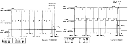

It has a similar failure mode on the 1000TX, although by all means the two technical manuals indicate they should work. I can type for a little while accurately, and then eventually either the computer or keyboard lose synchronization, and just start putting out period garbage for every keypress. Resetting the computer doesn't fix it.
Keyboard pinouts are nearly identical (except for the Reset that the 2000 keyboard isn't expecting, and whatever the "multi" stuff is for,) and the timing diagram seems to have been photocopied from one manual to the other:
Unexpected for sure. I find it a little unlikely that both the 1000SX and 1000TX would have identical keyboard controller failures, so I guess I'm going to be building a keyboard adapter. I don't think the keyboard is busted, though, as when it works, it works very well.
For the purpose of documenting this for future Google searchers, Chartreuse did point out that some Tandy 2000 keyboards say "Tandy 2000/1000" on them, whereas this one just says "TRS-80 Model 2000." It was floated that perhaps there's a later revision of the keyboard's firmware or circuit board out there that's more compatible, although I'm not sure how that could be from the evidence collected thus far.
