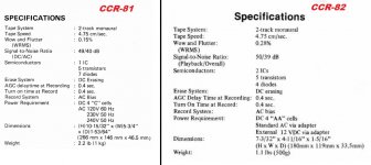

Well, to be thorough here - the CTR-80A manual doesn't include a Specifications section at the end. But the CCR-81 and CCR-82 manuals do, so here they are for comparison.

What is "DC Erasing"?

DC erase means it uses a permanent magnet to erase the tape while recording, rather than an electromagnet.
