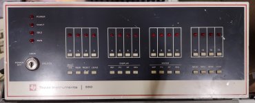

Here is the real version of my programmers panel.
A couple of issues on the Issue 1 board, should be correct on the Issue 2 schematic which i've attached.
The circuit is an exact copy of the TI panel but it's laid out to no specific size as as the time i didn't have a chassis it needed to match.

I have the Ti rack and one of Richards racks too. Agree the front panel does not fit Richards variant.
